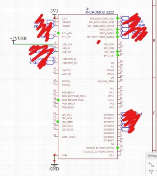

I have marked the pins with a green dot to make it easier to see.

RMII RX0 & RX1 are only available on those specific pins, so RMII and SDIO are an unresolvable conflict on MicroMod. If using RMII, any SD card needs to be connected by SPI rather than SDIO.
While the same is true for the 2 management pins and SPI, we could probably implement MDIO by bitbanging on any pins. Giving up the primary SPI port is pretty painful.

Here's my initial thoughts on the LAN8720A wiring. This mostly duplicates msg #3, but the MDIO pins are moved because conflicting with the primary SPI port is a huge cost for a feature we're probably not ever going to actually use. We can always bitbang MDIO if someone wants to access optional features.
We'll probably also end up not connecting RXER, but a first attempt should have a zero ohm jumper just in case. In theory, we can live without RXER (which conflicts with I2S audio) and allow the MAC to detect receive errors.

Thanks for the groundwork on this Paul. I started an Eagle schematic, pdf attached.
I'm not quite done, need to find an LDO and finish up the voltage regulation section. Maybe bring out some pins to a header and add an LED for debugging.
Let me know if I goofed on anything.
View attachment Teensy MM Ethernet.pdf
Here's a few possible issues I see...
VDDCR must not connect to 3.3V. This is the output of a 1.2V LDO regulator which powers internal circuitry. Add capacitors to this pin, but do not connect to any other power, only the capacitors connect to that pin.
Activity LED+resistor needs to connect to GND. During startup, the chip looks at whether the LED connects to GND vs 3.3V to enable / disable its LDO regulator. Connecting to 3.3V will disable the 1.2V power. See Figure 3-10 on page 32 of the LAN8720A datasheet for detail.
The other LED does connect to 3.3V (which configures LAN8720A to receive clock from Teensy and disable its crystal oscillator). But it's supposed to connect to analog 3.3V, not digital 3.3V.
Analog 3.3V should have decoupling capacitors. See Figure 3-18 on page 39.
R12 & R27 (49.9 ohms) and the transformer center tap (pin 6) probably want to connect to analog 3.3V, like in Figure 3-18.
I don't understand the 33 ohm resistors. Maybe they're meant for ESD? I don't understand why they would be between the 49.9 ohm resistors and PHY chip. Maybe that's ok?
I didn't (yet) check the connections to the M.2 pins.
I should also mention, a few other pins configure the chip (in the absence of MDIO usage) depending on their voltage at startup. But I believe they all have built in pullups for the settings we will use. And even if they don't automatically work, we can solve the problem with software that drives the pins before pulsing reset. So the 2 LEDs are the only config pins to really worry about getting correct pullup / pulldown, because Teensy won't have those 2 signals connected to GPIO pins.
might be less effort to use instead of the chips.
I don't understand how this design works with LED1 (pin 3) connected to a LED tied to 3.3V. Maybe the LED's forward voltage is enough that it doesn't conduct enough at startup to overpower the weak pulldown resistor inside the LAN8720A chip. But it's meant to be overridden by only 10K, according to page 32 of the datasheet, so I'd guess this LED connection is rather risky of having the 1.2V regulator not enabled.
I also don't understand connecting RXER to 3.3V by only 10 ohms. RXER is meant to be an output, right?
The 50 MHz oscillator would need to be removed, since Teensy creates the 50 MHz clock.
