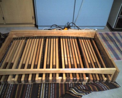

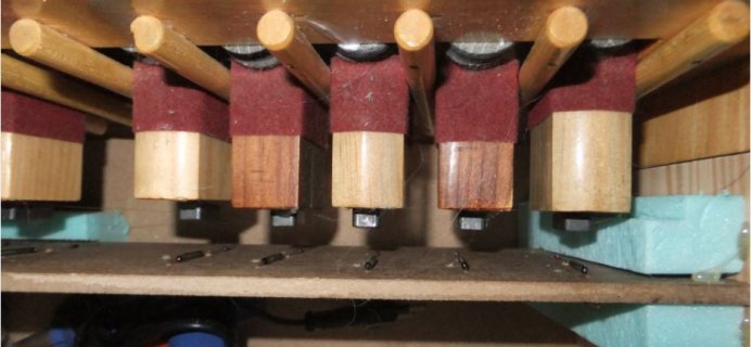

Hi everyone,
I've been doing a lot of Internet research in the past months, in orther to finish a BDO Organ Pedalboard I built myself a few years ago (Photo 1).
Now I'm trying to midify it with an arduino nano (I friend told me to use this one), but simply had no success.

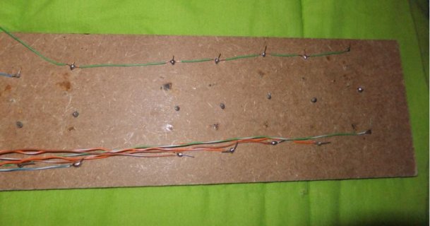

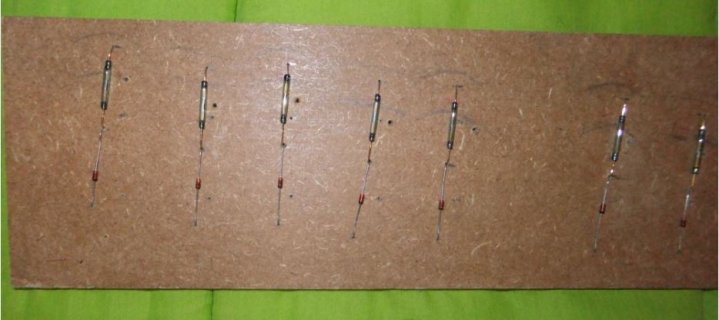

I found an wiring schematic (Photo 5) that I adapted to 30 notes in my pedalboard (5 x 6 matrix), and finished with the reed switches, diodes and magnets (Photo 2 and 4).
You can see the first 6 notes wires (Photo 3). There are 4 more groups like these.
The problems come when I connect everything to the arduino.

I would like to see the Arduino source code, but based on the schematic you provided I would speculate that the design is using multiple I/O to scan the pedalboard without using external multiplexer chips. See these articles for good examples of this approach.
<http://www.dan-nixon.com/2012/04/multiplexing-switches-on-arduino.html>
<http://www.dribin.org/dave/keyboard/one_html/>
Initially (i.e. in void setup(){}), all columns and rows are set HIGH. When the main program loop (void loop(){}) begins executing, it runs through a nested for-loop to read the entire button matrix. The outer loop iterates through all the column pins, each time driving one column pin LOW. The inner loop then reads all of the row pins to check if any of them are LOW; if the switch between a given row pin and the currently LOW column pin is being pressed, that row pin will read LOW. The "colPrev[cPin][rPin]" code is used to keep track of each button's prior state.
In pseudocode, here's roughly what's happening:
For each column pin
Set this column pin LOW
For each row pin​
Check this row pin
If this row pin is reading LOW​
If its previous state was not already LOW​
We have a new press. Update this button's state.​
Otherwise it was already pressed, and is still pressed. Do nothing.​
Else if this row pin is reading HIGH​
If its previous state was not already HIGH​
This button has just been released. Update this button's state.​
Otherwise it was not pressed, and is still not pressed. Do nothing.​
Reset this column pin HIGH​
Note that, using this multiple-I/O approach with 44 pins on the Teensy++ 2.0, you could theoretically scan up to 484 buttons. All those switches and diodes will likely cost much more than a Teensy! However, if you only need 30 buttons and your microcontroller has 30 or more pins, there is no need to use a multiplexing scheme. You can either:
1) Connect one contact of all buttons to +5V, and the other contact of each button to a separate pin for input. Use a loop to read all of the input pins; if an input pin reads HIGH, that means its button has been pressed. This is a scaled-up version of the technique described in <http://arduino.cc/en/Tutorial/Button>
2) A variation on the first option; set all input pins to INPUT_PULLUP. Connect one contact of all buttons to GND, the other contact of each button to a separate input pin. In this configuration, an input pin will read LOW if its button has been pressed. This is based on the technique described in <http://arduino.cc/en/Tutorial/InputPullupSerial>
