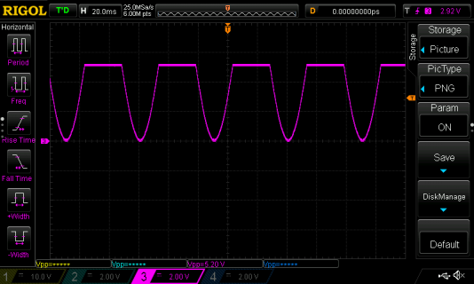

this is the normal library offset 1.00 on a sinewave with PT8211 Dac through an opamp bipolar 10 VPP
and i am trying to switch the offset wave for the same 1.00 value, to be:
Look, I want to help you. That's why I'm taking the time to write this message. But you need to understand the reason nobody replies is because you've not asked a clear question, nor have you followed the Forum Rule to show a complete program so people can see & reproduce the problem. We solve a lot of problems on this forum using blind guesswork when we can understand the need, and we fix a lot of tech errors without knowing much of the larger picture... but when neither of those are possible, usually nobody replies.
Thanks Paul, of course the code is from the library it self and it's good for a lot of purposes, something was described here about offset, this is why i was thinking it's a good place to start.
I am following the code but i can't figure it how to switch this as described in the pics above

I'm running your code from msg #12. It seems to work fine, producing either of those waveforms when the offset is +1.0 or -1.0.
But I *still* do not understand what you want to make this program do. Can you explain clearly what you want it to do that it is not yet doing?

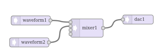

As a quick guess, maybe your intention was for a LFO to take the place of that encoder?
You could accomplish that by just feeding the LFO and original signal into a mixer. The mixer just adds together the signals.
Here's is the code (very simple...)
#include <SerialFlash.h>
AudioSynthWaveform       waveform2;      //xy=198,202
AudioSynthWaveform       waveform1;      //xy=203,130
AudioMixer4              mixer1;         //xy=387,155
AudioOutputAnalog        dac1;           //xy=555,127
AudioConnection          patchCord1(waveform2, 0, mixer1, 1);
AudioConnection          patchCord2(waveform1, 0, mixer1, 0);
AudioConnection          patchCord3(mixer1, dac1);
  AudioMemory(16);
  waveform1.frequency(110);
  waveform1.amplitude(1.00);
  waveform2.frequency(0.1);
  waveform2.amplitude(1.00);
And this is the result on my oscilloscope. It's the same as if someone slowly turned the encoder.

Ok, let's see it bipolar, presuming -5V 0 +5V peak to peak for the sinewave then.
Maybe half rectifier is the right term here.. I was think for an inverted offset function in my mind :))

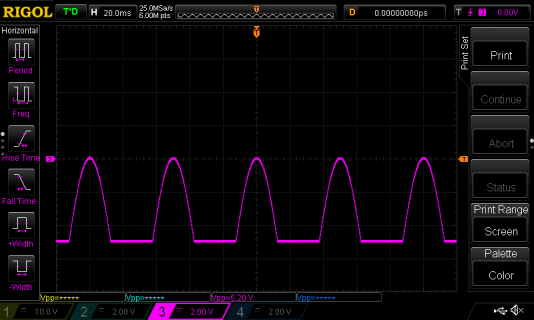

i just want to control the amount of the offset as on the code on msg# 12 but when going for from 0.00 to 1.00 the positive (+5v) part to stay untouched (like it's half rectified) and the negative part (-5V) to shrink to 0 as the amount is given by the encoder (pic)
0.00 for full bipolar waveform and going to 1.00 only +5v part of the waveform:
AND the same behaviour for the -1.00 amount (-5v) waveform part to stay untouched and positive +5v part to shrink to 0
My purpose is to modulate external gear FM, CV, Envelopes and i am thinking it's more usefull if we invert the function offset, but as i mentioned above, half rectified is the right term here, so this is why checked in the library code offset function in the first place

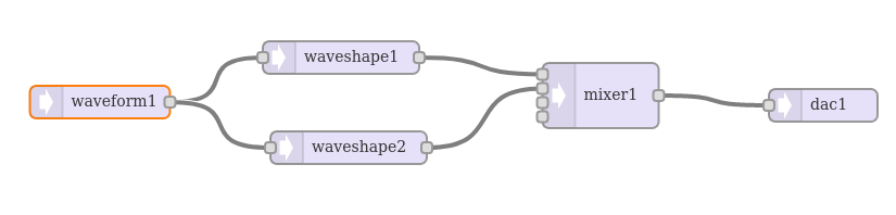

You can use the waveshape effect to get the half wave rectified behavior. Create 2 of them, one for the positive half of the waveform and another for the negative half.
Then add the 2 halves back together with a mixer, where you can control the gain on each channel. To get "from 0.00 to 1.00 the positive (+5v) part to stay untouched" set the gain to 1.0. For the encoder to control the amount of the negative part "the negative part (-5V) to shrink to 0 as the amount is given by the encoder (pic)", just write some code for the encoder to adjust the gain of the other mixer input.
Here is very simple code which sets the negative half gain to 0.33.
AudioSynthWaveform       waveform1;      //xy=167,118
AudioEffectWaveshaper    waveshape1;     //xy=389,77
AudioEffectWaveshaper    waveshape2;     //xy=396,160
AudioMixer4              mixer1;         //xy=628,112
AudioOutputAnalog        dac1;           //xy=833,121
AudioConnection          patchCord1(waveform1, waveshape1);
AudioConnection          patchCord2(waveform1, waveshape2);
AudioConnection          patchCord3(waveshape1, 0, mixer1, 0);
AudioConnection          patchCord4(waveshape2, 0, mixer1, 1);
AudioConnection          patchCord5(mixer1, dac1);
float positiveOnly[3] = {0.0, 0.0, 1.0};
float negativeOnly[3] = {-1.0, 0.0, 0.0};
  AudioMemory(16);
  waveshape1.shape(positiveOnly, 3);
  waveshape2.shape(negativeOnly, 3);
  mixer1.gain(0, 1.0);
  mixer1.gain(1, 0.33);

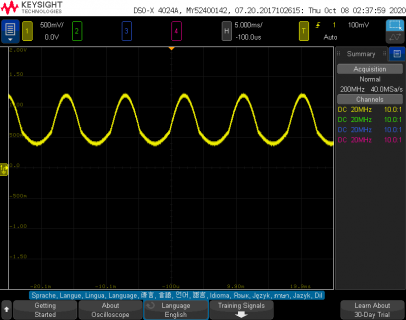

Here is the resulting waveform. You can see the positive half is unaltered, but the negative half is reduced in amplitude. Hopefully that is what you wanted?
I did played with the code and it's nice to experiment by giving values from the encoder to the mixer gain.
But i think more simple is to invert the offset poles in sort to speak, maybe Halfwave effect function will do the trick anyway
