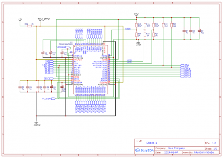

I've been playing around with the PCM3168, a near-alternative to the CS42448 which is now shown as discontinued on Cirrus Logic's website. From a functionality point of view, the PCM3168 doesn't have the ability to add another pair of inputs via an auxiliary interface, so you're limited to 6 in 8 out, but otherwise it seems a fairly straightforward replacement.

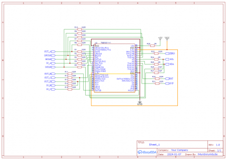

From a software point of view, it works with the existing Audio TDM objects, barring the bug I recently found. I does of course need a control object, which can be found at https://github.com/h4yn0nnym0u5e/Audio/tree/feature/PCM3168
I've had 5 evaluation PCBAs built by JLCPCB, using the following schematic. I allowed for multiple options on which Wire and TDM interfaces to use, and the option to use I²S instead of TDM; as manufactured, it uses Wire and TDM2, which is all I've tested for now. The RST, ZERO and OVF pins are connected, but only RST is needed. The I²C address pins are also selectable - as-built it uses address 0x44.
PCM3168:
Teensy:

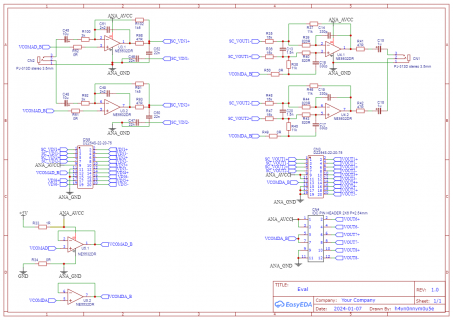

Analogue I/O:
The PCBA as built has several issues:
  • the analogue section doesn't work from the 5V supply: it needs ±12V connected to ANA_AVCC and ANA_AVMM
    • fix by removing R53 and R34, and wiring a 5V -> ±12V DC-DC converter to the headers
    • there's a track cut needed at U5 pin 4, and then that pin wiring to ANA_AVMM
  • I messed up on the BoM, so many of the resistors are 100R rather than as-marked on the schematic
I'm sure the schematic, layout and component choices could be significantly improved with regard to analogue performance! It really is just for evaluation / messing about with, rather than serious use.
All that said, I probably don't need all 5 PCBAs, so I'm willing to let three go at cost (say £25 each inc. shipping) , ideally to people in the UK as I really don't fancy messing with Customs forms. I'm not interested in making any more, but I will post the Gerbers and (corrected) BoM if people want ... unless someone has the knowledge of how to make a project public on JLCPCB.

One quick question now. I don't quite understand capacitors C50 and C52 on the analog schematic. What do they do?
Here you go! The dangly bit at the right is the DC-DC converter, and the DuPont cabling is connecting two differential outputs back to inputs for testing.
I have no idea on C50 and C52, I cribbed them straight from “Figure 60. Buffer and Anti-Aliasing LPF for Single-Ended ADC Input” of the datasheet’s System Examples.
C46/47/50/52 provide very low impedance (at HF) to the ADCs while they are sampling - usually needed to get to datasheet levels of SNR. The opamp by itself will have quite high output impedance at HF, allowing ADC input currents to inject noise into the signal they are trying to measure - at least that's how I understand it.
Thanks Mark, good to know. I did find it slightly weird to have just C46 / C47 grounding the VIN- pins: seemed one step away from leaving them floating. But as a software guy who knows just enough about hardware to be dangerous, I'll go with the datasheet.

So, if I understood correctly, with your examples, it is not possible to use the SD card in conjunction with this library? Or can I use it with this library by using just TDM?
Not an expert but I'm a bit confused
You should be able to use an SD card just fine, I don’t think it clashes with either TDM or TDM2. If you use the Teensy 4.1 built in slot then that’s definitely OK, I’ve tried it.
Note the EasyEDA Teensy footprint uses conventional pin numbering, not Arduino-style numbering. So though it looks as if pins 10 (CS) and 11 (MOSI) are in use, actually they aren’t.

Speaking of which, if I wanted the board to support 4 single channel outputs (RCA or solder) should I just remove the CN3 entirely and route the 28-25 pins to the analog out assemblies similar to both out channels on CN1? Note, I'm definitely an electronics novice, don't be afraid to tell me that this is a horrible idea.
It’s slightly easier than that. The output stage is only connected if you fit 4 jumpers to CN3, jumping 1-2, 3-4, 5-6 and 7-8. So just design your analogue out as you see fit, and connect to the odd-numbered pins on CN3 (VOUTn+/-). VCOMAD_B on pin 14 is the output offset reference, you’ll need that, but I messed up the power supply to the buffer U5 so that needs fixing. To use all 8 outputs you need CN4 as well. I forgot to check the alignment of the headers, so there’s no reason to expect them to be on a 0.1” grid :( .
If you’re rolling your own PCB then the above is academic. Just use as much of the Teensy and PCM3168 pages as is useful, and the analogue page for guidance only. Bearing in mind that I designed for evaluation so there’s lots of flexibility by swapping resistors in and out, and there’s the buffer power supply error…
