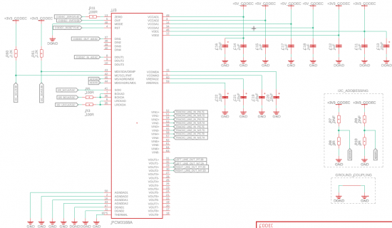

I built a board using the schematic placed here and I can't make the teensy to recognize the pcm. Ran an I2C scanner and got a Unknown error at 0xYY (all the addresses that is scanning). Set Mode directly to digital ground for I2C as the datasheet states, 2K2 pullups on SDA and SCL and ADDR0/ADDR1 both to ground (by 0 ohm resistors) but no luck at all.
Does the .enable method on the control code you sent sets true when the pcm is correctly initialized?
Any thoughts? Attached is the schematic I used

Yes, I did reset the codec, placed AudioInputTDM / AudioOutputTDM objects. I get noise on the outputs, if I change the address with setAddress the output varies, wrong address, no output, right address noise (a lot). Here's a snippet of the code I'm running:

Included the control object from h4yn0nnym0u5e repo. I can see the clocks arriving from the Teensy.
That all looks OK. Can you post your layout? I seem to recall issues for some people running I²C near the I²S bus - it go so noisy the I²C stopped working.
Here's an adapted version of my initial test scan code, which I've just runs and is working (apart from apparently picking up extra addresses that aren't really active):

Well, there's something that's pulling the SDA/SCL lines down on the PCM. I got low voltage readings on those pins, on a board that have the PCM removed voltages are normal so no issues with the routing of those lines. Even without the Teensy attached to the board those lines are down in voltage.
Pull down resistors are ok, 3v3 line is ok, no shortcuts to ground or any other power plane/trace.
Is too much to ask to get some voltage readings of the reference pins?
I'm getting about 1.84V on both VCOMAD and VCOMDA; that's lower than I'd expect, as VCC is about 4.5V. I can't get to VREFAD1 and VREFAD2 to check those voltages.
VThanks, I'm getting 5v on AREFAD1, 0v on VREFAD2, 2.5V on VCOMAD and 0V on VCOMDA. The 2.5v comes from the reference of the analog part on the input, but the out is decoupled so 0V reference I think.
Last update, got to the point the Teensy can see the PCM. I had an external analog reference, took it out and used the VREFAD as reference and got the SDA/SCL lines up to the right voltages. After that I figured out I had another I2C device on the same address, changed the address and finally can see the PCM on the scanner and the initialization method returns true.
Now I have to debug the audio part. I need 4 inputs (Vin1, Vin2, Vin3 and Vin4) and only two outputs (Vout1 and Vout2) but got a bit scrambled with all the Dins and Douts that the PCM have, all of them must be connected to the teensy?
Good news! At least you didn't need to do too many hardware mods :)
Looking at the data sheet (January 2016 edition) to remind myself, Table 11 on page 33 and Figure 52 on page 34 are pretty useful. Essentially for "normal" TDM use you just need DIN1 and DOUT1 connected (their I²S / left-justified TDM Single mode). If you want 96kHz, you need to use Dual mode, and wire DIN2 and DOUT2. The first option is what's supported by the standard Audio library; the second requires a revised library - see post #33 above.
In my proof-of-principle design, I routed all the pins via 100R resistors so I could explore all the possibilities, which was probably confusing of me.
Yeah, at least that was not that much of a deal.
