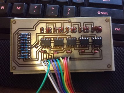

I'm using MSGEQ7 audio spectrum analyzer ICs to turn a strip of LEDs into a audio spectrum visualizer. I had originally designed this project to use an arduino UNO but due to other aspects of the project I switched to using a Teensy 3.1 for this portion. Switching back is not an option.
The hardware is pretty simple, I'm using a MAX4466 electret microphone with adjustable gain, input voltage from 3-5v (5v recommended, though I've had better results in all cases with 3.3v input). The output from the microphone goes to the MSGEQ7, 3-5v input (5v recommended) which breaks the audio signal into 7 analog signals, one for each frequency band. Those signals are then read by the controller and mapped to brightness values on the LED strip.
To get additional frequency bands I'm using 5 MSGEQ7's total with their clocks shifted by various capacitors and resistors to give me a total of 35 bands. I built this on a homemade double sided circuit board (probably not relevant but I'm proud of it so I'll post it below).
When using the UNO I powered the microphone with 3.3v, the MSGEQ7s with 5v, and was able to read all of the analog outputs with acceptable levels of noise without any fuss. BUT, now that I've migrated to Teensy, I run into a problem (about problem number 300 on this project).

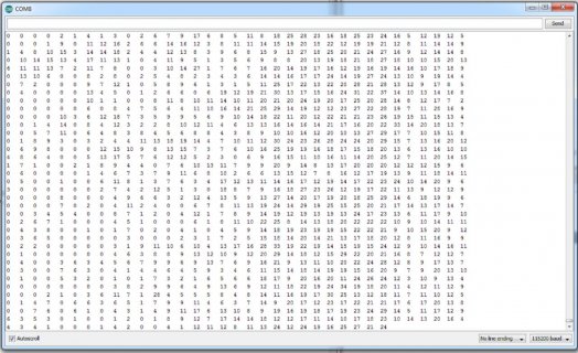

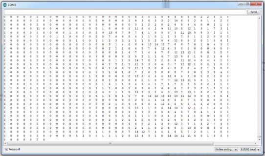

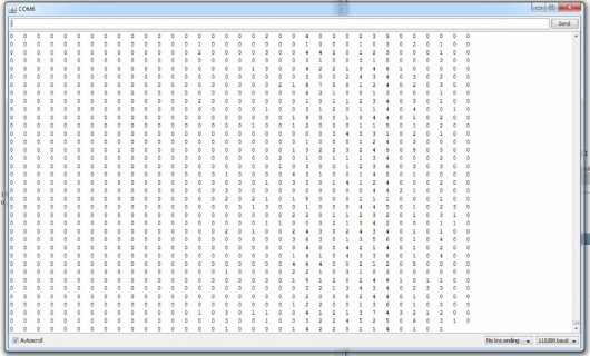

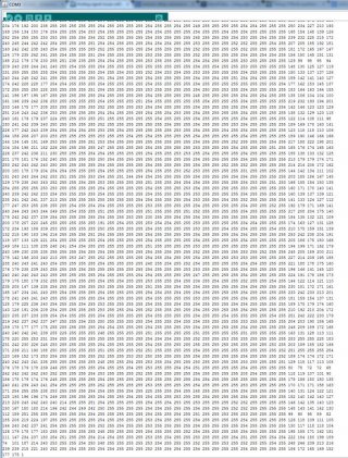

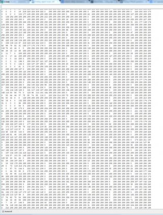

Here's what my values look like in the serial monitor in a few different setups. (they're legible on my screen, let me know if they aren't on yours):
UNO, microphone: 3.3v, MSGEQ7s: 5v.
Teensy 3.1, microphone: 3.3v, MSGEQ7s: 5v.
Teensy 3.1, microphone: 3.3v, MSGEQ7s: 5v w/voltage divider.

Your screen dump are unreadable -- too small.
I don't think ADC noise is likely your issue. Check your signals with a single tone input (use a Teensy to generate one if you don't have a whistle), and see if the expected output is there.

Thank you all for the responses! I already have many more solutions to explore than I had on my own.
Jp3141:
"Your screen dump are unreadable -- too small." - I have increased the size of the screenshots.

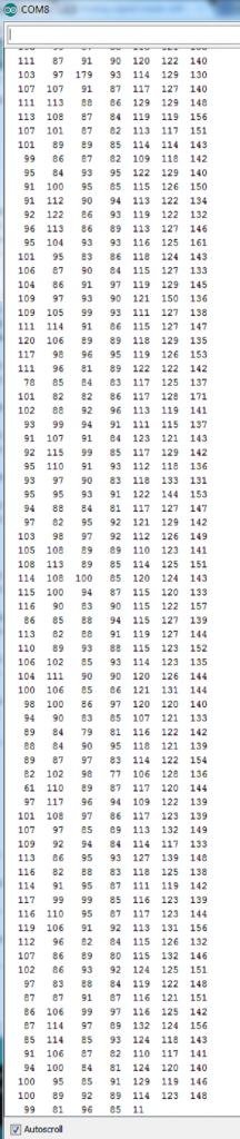

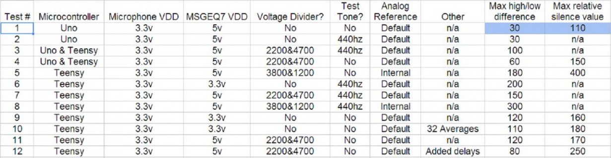

I simplified my code to only print raw values to the serial monitor and I'm currently only reading the data from one of the 5 MSGEQ7s until I get this noise issue settled.

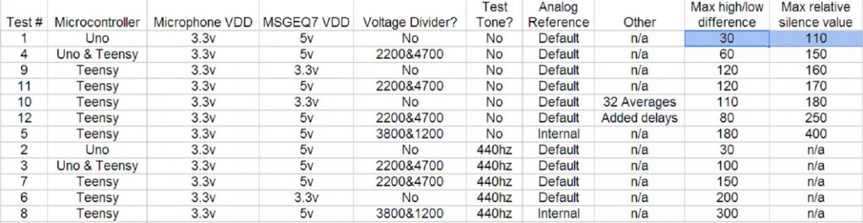

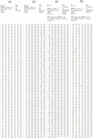

I ran a bunch more tests with some of the suggestions above. All tests are with the microphone input voltage at 3.3v, and using the analog ground of the Teensy. Any test tones are at a fixed volume and speaker to microphone distance for all tests. Here are my results compiled into 3 images:
Tests 1 - 4:
#1) The original setup using an Arduino UNO. Microphone VDD: 3.3v, MSGEQ7 VDD: 5v. Pretty consistent values, maximum high/low difference of ~30. Max relative silence values around ~ 110.
#2) Same setup as #2 with a 440hz tone. Pretty consistent values, maximum high/low difference of ~30 as above.
#3) I powered the microphone and the MSGEQ7 with the 3.3v and 5v (respectively) pins of the UNO played a 440hz tone. The output of the MSGEQ7 was read by the Teensy after transforming the max signal voltage to ~3.3v with a (2.2kOhm --> series, 4.7kOhm --> ground) voltage divider. Grounds of the Uno and Teensy were tied together. This is probably my best setup with the Teensy so far with max high/low differences of ~100.
#4) Same setup as #3 with no test tone. Max high/low differences of ~60. Max relative silence values around ~ 150.

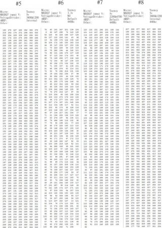

Tests 5 - 8:
#5) MSGEQ7 VDD: 5v, (3.8kOhm --> series and 1.2kOhm --> ground) voltage divider brings the signal range to ~0 - 1.2v. The internal analog reference of the Teensy is used. Max high/low differences of ~180. Max relative silence values around ~ 400.
#6) MSGEQ7 VDD: 3.3v. No voltage divider. 440hz test tone. Default analog reference. Max high/low differences of ~200.
#7) MSGEQ7 VDD: 5v, (2.2kOhm --> series, 4.7kOhm --> ground) voltage divider brings the signal range to ~0 - 3.3v. 440hz test tone. Max high/low differences of ~150.
#8) MSGEQ7 VDD: 5v, (3.8kOhm --> series and 1.2kOhm --> ground) voltage divider brings the signal range to ~0 - 1.2v. The internal analog reference of the Teensy is used. 440hz test tone. Max high/low differences of ~300.
Tests 9 -12:
#9) MSGEQ7 VDD: 3.3v. No voltage divider. Default analog reference. Max high/low differences of ~120. Max relative silence values around ~ 160.
#10) Same setup as #9. analogReadAveraging(32) is called. Max high/low differences of ~110. Max relative silence values around ~ 180.
#11) MSGEQ7 VDD: 5v, (2.2kOhm --> series, 4.7kOhm --> ground) voltage divider brings the signal range to ~0 - 3.3v. Max high/low differences of ~120. Max relative silence values around ~ 170.
#12) Same setup as #11 with 1 millisecond delays added after any pin state change or reading. Max high/low differences of ~80. Max relative silence values around ~ 250. This one is odd as only altering the code increased the maximum relative silence values and substantially smoothed the high/low difference. This slowed the program way down though.
A table sorted by test #.
A table sorted by max high/low difference

Sadly, this doesn't seem to give much or any improvement with a maximum high/low difference of ~60 in the screenshot and worse in live tests.
I noticed that in this screenshot, taken in relative silence, the "noise" on the lower two frequencies seems to be roughly the shape of a sine wave. Odd.
Does this mean that the output zero is actually 600 mV? In this case with a supply of 3.3V this would correspond to 180 counts, which is what you see with a Teensy and 32 averages.
I believe so, yes. I'm guessing this is why a 5v supply is recommended. I'm not sure why I would be getting such high values still with the supply voltage at 5v and the signal sent though a voltage divider though.
There's something else I don't understand: "The multiplexor read rate is also the output decay time control. Each read decays that channel approximately 10%." So maybe timing is important.
I was hoping that that was the case but, beyond what I just tried, I don't know what else I could do in this department.

I did notice something odd in a test I did earlier. I used my original code in two different setups, then simply blew on the microphone to max out all the values. With all 5 MSGEQ7s being read, each one is responsible for every 5th frequency.
1) Original setup, all 5 MSGEQ7s
2) UNO powering the msgeq7s (at 5v) and microphone with the Teensy taking the readings (grounds tied together, no voltage divider). My understanding with not using a voltage divider here is that the signal should read, and any fluctuations should be, proportionally higher up until the 3.3v mark where it will just read as ~1024. This doesn't explain the crazy erratic values I get.
1)
2)
Using the Teensy, the MSGEQ7 that's shifted the lowest, frequency wise, gives extremely erratic values for each frequency it's responsible for. The lowest frequency of the other 4 are erratic as well. I have no idea why it would do this when being read by the Teensy and not when read by the UNO while being powered by the same source in each test.
