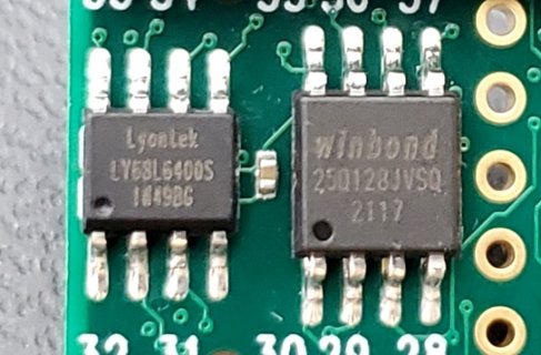

I have seen the LY68L6400S mentioned before, but found no confirmation if they were in fact a valid alternate so I brought some in to test since chip shortages are going to be around for awhile.
These appear to be the exact same as the ESP PSRAM64H and have the same chip ID.
You do want the 'S' version for the SOIC. The 'B' version is the WSON package. Here is the Datasheet
Tested 5 chips on 5 Teensy 4.1 using the standard PJRC teensy41_psram_memtest and they work fine.
Available from LCSC, Aliexpress and ProtoSupplies.com will be adding them to our mix of products as well.

the one difference I see in the from looking at the datasheets is the max clock speed. It looks like for the Lyontek LY68L6400S the clock is maxed at 100Mhz while for the ESP its at 133 Mhz. This shouldn't be a problem as the default clock is set at 88Mhz. We have tested the ESP chips up to pretty close to the max and it worked. Only warning would be not to exceed 100Mhz in your apps.
I'd be happy to send some to Paul if he would like to test them himself and add them to his approved alternate list.
Sure. Send me just 2 chips. I'll solder one to a Teensy 4.1 and run the memory test. Assuming it passes, I'll use the other for a photo to add to the PSRAM page. The 3 photos on the page today are the 3 chips I have personally tested. PJRC is currently shipping the Espressif chip, but we've purchased Ap Memory parts and will switch to those when the Espressif parts run out.
I'm pretty sure all of these various 8 MB QSPI PSRAM chips are really the same chip made by Ap Memory and then printed with different part numbers for different buyers.
mjs513, the datasheet I linked to from LCSC site is Rev 0.7 and shows 144MHz max data rate. There is an older datasheet I have come across that showed 100MHz, so I think they updated it at some point. The actual Lyontek website doesn't currently show a datasheet I could find and they list the part as sampling, though they are clearly shipping.
Paul, chips are in the mail. Should have them tomorrow.
