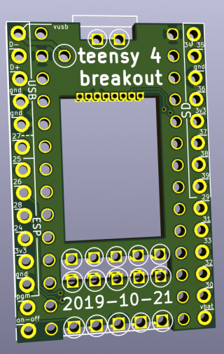

Would it be possible to have pin #'s on the bottom silk screen? At least for the pins > 23? I really don't want to have to refer to an online site when I'm bringing out pins.
Good suggestion. I'll see what I can fit in there! How's this?
That looks very good! So much better to see silk screen refs to prevent confusion in flipping the board.
Question why are pin #34 and On/Off a square pad?
No good reason, they were like that in the original default footprint for the header that I used. Rounded them out:

I've put together a design for a combination USB Host and SD breakout board. The idea is that it straddles atop the teensy and connects via a tall-ish header to the original Teensy 4 breakout board below. It has the SD slot on one side and the USB A connector on the top side. This way you can use the Teensy 4 on a traditional perfboard and still have the SD and USB connectors, which are all at one end.
Details here: https://github.com/blackketter/teensy4_combo_breakout
Would love feedback on this approach from anybody who can take a look. Thanks!
