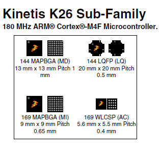

That was 40 pins with a 32 pin connector - and not shown the 144 pin K26 - you suggested the 13x13mm BGA might be the one
The 144 (.5mm pitch) wouldn't work? I mean, i'm assuming it wouldn't work due to the sheer size of it, but .5mm pin pitch isn't bad at all. The current 3.1 chips are .5mm pin pitch.
Edit: the .65mm/.4mm BGA pitch would be a nightmare to route - vias-in-pad would be the only way I could think of doing it.

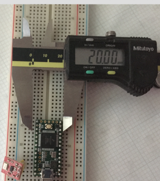

It would be tough. Just the bare chip is wider than the current T3.x, and the widest you can go while still being able to fit in a standard breadboard (about 23.5mm) only gives 2mm from end of pins to end of board[*]
[*] using the 2nd pins from the edge on each side -- you can go wider by using the outside-most pins but that means you'd have to pull the board off every time you wanted to add/change a jumper. I suppose you could require double-wide breadboards ....

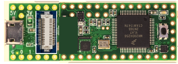

I copied those p#227 images from thread Is-there-a-market-for-a-Teensy-3-1-48-pin-ARM-stamp ... that 32 pin connector is used on this device family: https://tiny-circuits.com/tiny-shield-proto-board-all-159.html - as noted they offer a $4 minimal proto board with two connectors installed.

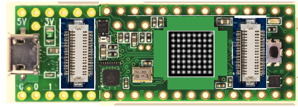

Putting one of those on each side of the K26 might ease routing to the primary pins & the takeoffs - and give options for twin connects (bias one to Analog?) w/larger number of exported I/O from the 144 pins:
tx2.png- but they may never be used and would add to cost - and any project using them would need the mate. A ribbon board to board is $15.
I don't want to completely rule this out, but I'm not a fan of these high density connectors.
I know Intel Edison uses one. I know others have gone down this path, some more successfully than others have tried.
Some of my reservation is a concern this doesn't fit PJRC's business model. Teensy has never been about making a comprehensive collection of "shields", or whatever you'd call such a plug-in peripheral board. If I were to start down this path, odds are very likely the dev time that I currently put into creating more advanced software (OctoWS2811, Audio, PulsePosition, ILI9341_t3, SD_t3, SerialFlash, Biopotential, new USB types, FreqMeasureMulti, etc) would almost certainly be consumed by making and supporting lots of hardware. Many other companies in this "maker market" do this, and indeed it seems to be far more profitable than PJRC's approach. My decision making is really not about what will make the most money or conquer more of the market, but rather how to maximize (or at least sustain and continue to fund) my ongoing efforts to develop awesome stuff.
I'm also reluctant to create yet another plug-in form factor. Teensy is probably among the more successful "unofficial" Arduino compatible boards, at least in terms of actual usage in real projects. But so far, to the best of my knowledge, Teensy's pinout & form-factor has yet to be adopted by any other board. Even Arduino Zero clones that could have benefited from Onehorses's many "appallingly small" peripherals haven't been swayed to align their power and signals similarly.
So to even begin to consider this, I'd really want to be interchangeable with an already-established format. (hint, hint... to anyone who wants to persuade me....)
Cost is also a concern. I've always tried very hard to keep Teensy affordable. These connectors vary considerably in cost. Some of the cheaper ones may be designed for only a very low number of "cycles".
PCB real estate is also a possible issue. There are a lot of possible ways to use the space. One space-hogging idea I have in mind involves using the right hand side for the same SD socket we currently put onto the audio board and Wiz820 adaptor, with wiring to the native SDIO pins on this K26 chip. I also really want a convenient way for people to connect to the other USB port (the 480 Mbit/sec one), which probably will end up being a location to solder a 4 or 5 pin header that mates with the common USB-to-motherboard cables made for PCs. These, plus the large 13 mm chip and other stuff required all add up to not much PCB space left over.
Lots of Pros & Cons to see and weigh. A T3k26 would offer awesome compute power - new fast protocols in larger number. Though: too big with unused pins is as bad as not enough pins depending on the use case.
Teensy seems to be the DIY for DIY'ers - I wasn't suggesting a PJRC emulation of that 'Tiny' ecosystem - just the ability to get needed pins from a smaller format - while largely preserving the T3.1 layout. No matter what the layout is it will be new and need adapted to.
If you decided to design it with a mind to make a 52 pin T_monster version for bench use and design, then lop off the end for a 40 pin T_svelte version. Of course the width limits routing options and only gains 12 pins. In which case the T_svelte 40 pin with a 32 pin connector would beat that handily, and a sample daughter card could be designed with 5v tolerance built in - a perfect 16 pin onehorse project.
Another issue is cost. I'd wager that the BGA version would likely require a 6-layer board to maintain the skinny form factor yet extract all those signals.
