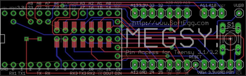

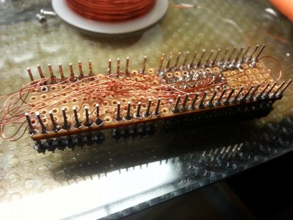

Faced with the choice between adding lots of extra support logic, or finding some way to access the tiny pads on the back of the Teensy 3.1/3.2, I finally decided to do something about it.
So first, I got a bunch of magnet wire and some protoboard and made this mess:
Unfortunately, in the process of making it I somehow bridged a couple of pins inside making it slightly less useful. Also, doing that was a huge pain in the ass.
So I spent an evening in the CAD software and came up with this board:
I know this has been done before by other people, but I think my design is just a wee bit more compact and hopefully easier to assemble.
The idea is a kind of "poor man's BGA", where you assemble it by tinning the pads on the teensy and on this board, use the edge headers to align the two boards and then squish them together and melt the solder on the pads by applying heat to the vias on the bottom of the board.
A couple of nice things: I added a reset button on the "extra pads" side so that if you are covering the Teensy with a shield (or cape or whatever the Audio Board is called) you now have a way to reset your board again. I also added an optional pin for it, which you could attach to the bottom or top of the board as you desire.
I've also put nice labels on the silkscreen noting not just the pin number, but also certain functions like Analog and I2C, etc.
I haven't actually sent out for them yet to see if it will work. I thought, before I do, I should see if an official Teensy 3++ is imminent. If we are less than a month out, I'll just wait and all I've lost is a few evening's work. Otherwise, I'll spend the $40 and build some of these.
I made a Hackaday project for this under the cheeky title of "Megsy": https://hackaday.io/project/11367-megsy-a-homebrew-teensy-3
So, should I order them, or is Teensy 3++ or 4 or whatever imminent?

@SoftEgg - Have you seen this OSH contribution? Teensy 3.2 Breakout Board R3
It has the bottom routed out to give better solder access to the pads - should help prevent the unfixable bridging. I got some that look good - but not needed any yet. I've used FrankB's simple connector board that solders similarly (except the cut is reversed) - it brings out the bottom pads - but not breadboard friendly - you could make a simple second board to adapt end to end and bring the inner 10 pins out to the edges though.
