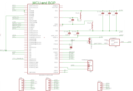

So I decided to have some fun and try out making a Teensy 3 board using the Mini54 option. However, I am encountering a very unhappy chip - though I have power in all the right places and no shorts, the board behaves as if it was not plugged in. I have no doubt that the fault is mine, I am simply trying to track down a reason.
I get 50 retries to no avail, so I wonder whether I cooked the Mini54 somehow or the Kinetic chip. Is there a way to see if the Mini54 or the Kinetic are 'alive', i.e. some sort of heartbeat program / protocol? Unfortunately, I do not have a LED on SCK, but if the Mini makes the Kinetic blink the way I remember the Teensy 3 does on arrival, I could look for that with my logic analyzer or oscilloscope.
I'll post the connections I made next. There seems to be no difference between the real world vs. the planned connections - I used my DMM to determine the resistances and if there were any shorts to other pins. I found none. However, the very large lands around the Mini54 as designed in Eagle made for a big mess and I had to remove a lot of excess solder (i.e. thick dollops of flux and braid necessary). I wonder if I managed to "cook" the mini54 in the process.

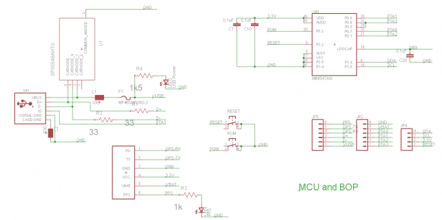

The Mini54 resides on a daughterboard because that was the easiest way for me accommodate the two chips on a 2-layer board.
Here are their circuits. Did I miss anything obvious?
First, the daughterboard - it features a TVS array in addition to the usual suspects found on the Teensy 3 board.

The main board interfaces with the daughterboard via 3 single-row headers. I confirmed that the two connection lists match up.
Two things come to mind from the schematic:
1 - it looks like you've got VOUT33 on the MK20 disconnected but on the PJRC schematic it's connected to VCC/VDD. I did a quick glance through the MK20 datasheet and it says you can leave it floating if you don't use USB at all, but section 3.9.1.2.2 makes me think the connection should be there…
2 - Have you checked the mapping of the USB connector symbol to the pads? On the schematic you've got (top to bottom) +5V, USB+, USB-, ID, GND, but actual wiring is +5V, USB-, USB+, ID, GND (USB + and - reversed).
Other random thoughts:
It looks like you're using a different library part than I am; I've used this one http://forum.pjrc.com/threads/24006-Eagle-library-for-MK20DX128VLH5?p=34199&viewfull=1#post34199 for the mk20 and mini54 and it mostly works. I'm sure you've checked the pinout but if you want to post it I'll have a look.
In my design I didn't connect the USB ID pin because my connectors don't have it. I don't think it will affect anything; I think it's only needed for the USB On The Go, but you could try cutting the trace just in case…
I don't have anything like the SP0504BAHTG in my design; I just go straight from the USB data pins to the series resistor into the MK20. I don't think it would cause any problems but again, you can try removing it to try to isolate the issue.
Excellent observation. I was under the impression that one would ideally not backfeed a voltage regulator, even if nothing is attached upstream (i.e. VREGIN). I have since retrofitted a single wire that runs from 3.3V to the output of the regulator. So far, with no effect. I also replaced all the OSRAM PointLEDs and attached them with their 'Cathode' on the positive side of things and now they work. (Just not as initially expected)
I will look into that again, but for now, a review of the pinout IRL suggests that D- is D- and D+ is D+. I will double check to confirm D+/D- assignment by DMM with a USB-A cable.
Yes, the MK chip came from my own library and chances are I will also author a Mini54. The long pads that may make drag soldering easier threw me for a loop with my paste/reflow oven approach. The pinout for the Teensy chip is below and I appreciate your willingness to have a look at my pin assignments!
I may also drop the ID pin or GND it, as most USB-A/Micro-B appear to anyway. I will attempt to isolate the problem as per your and Paul's suggestions. My money for the time being is on a cooked Mini54 chip. But the logic analyzer will confirm all that tomorrow, I hope!
