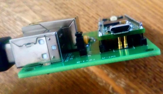

we have developed this board for our internal use. If there is some interest we might sell it on amazon.
any feedback on pricing?
Our small volume build of 5 was quite pricey.

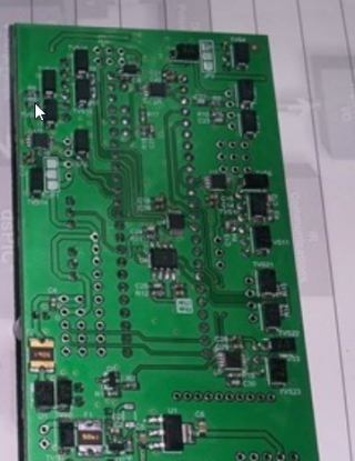

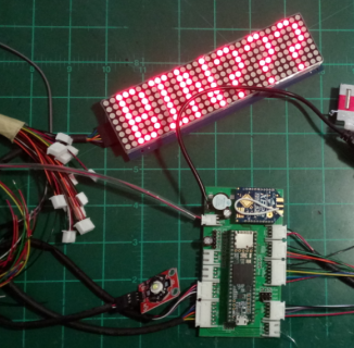

The useful thing about this board is it sends power and ground to many, many connectors making it useful for wiring in sensors and peripherals.
Some pins end up as jst connectors and some end up as 0.1 inch pitch through holes (with power and ground nearby) so you can solder on your own header pins.
We also have a nicely color coded wiring harness for you to connect directly to your favourite outputs!
Some of the pins are buffered.
This board breaks out 5 serial ports.
One of the serial ports goes to an xbee format header with 3.3 v.
You have to supply this board with regulated 5v, it does have an inline thermal fuse.
It does have a powered square wave buzzer on the usual pin.
It has a built in voltage divider on an analog pin so you can measure supply voltage.
At the moment it doesnt break out any of the pads or pins underneath.
This has been really useful to us. I wonder how many other people in the world there are with similar pain points that prompted us to design this board.
Oh and of course it does work with teensy 3.2!

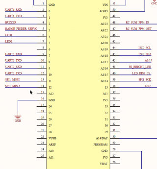

these are the pins we broke out:
S_GPIO3_PIN 6 //CN16 CS on teensy 3.2
SD_CHIP_SELECT_PIN 6 //"SS" CS for sd card reader, not needed, teensy 3.5 uses built in sd card reader
// UART3_RXD pin 7 // CN8
// UART3_TXD pin 8 //CN8
// UART2_RXD pin 9 //xbee and CN7
// UART2_TXD pin 10 xbee and CN7
MOSI_PIN 11 //CN9 SPII DATA input to device
MISO_PIN 12 //CN9 SPII data output from device, not needed for led display
// 3.3v
S_GPIO4_PIN 24 //CN17 not connected on teensy 3.2
//25 - 30 : not connected
// UART4_RXD pin 31 // CN3
// UART4_TXD pin 32 //
//GND
// 46 - 40 not connected
// round the corner
//VBAT 3.3V GND PGM RST
// round the corner going up
//3.3 v
//47 to 53 not connected
UART5_TXD pin 33 // CN4
UART5_RXD pin 34 //
//CN21
S_GPIO9_PIN 35 // not connected on teensy 3.2
S_GPIO8_PIN 36 // not connected on teensy 3.2
S_GPIO7_PIN 37 // not connected on teensy 3.2
S_GPIO6_PIN 38 // not connected on teensy 3.2
S_GPIO5_PIN 39 // not connected on teensy 3.2
S_DAC0_PIN DAC0 //CN20 not connected on teensy 3.2
S_DAC1_PIN DAC1 //CN19 not connected on teensy 3.2
//gnd
ledPin = 13; //
SPII_SOFT_SCK_PIN 14 //CN9
SPII_CS1 15 //CN9
LED_PIN 16 //CN10
pintrig 17 //CN8 DIO pin
// I2C SDA pin 18 // CN13
// I2C SCL pin 19 //CN13
S_A6_20_PIN 20 // CN18
// pin 21 VBAT
