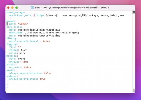

Sorry about the delay. I haven't forgotten this problem. In fact, while recently working on serial monitor support for upcoming Arduino 2.0, I completely rewrote the Mac serial monitor code to avoid CFFileDescriptor stuff.
If anyone is still watching this thread, please run this and let me know if it's stable on your Mac? It seems to work well on my 2015 MacBook Air which definitely does crash with the test from msg #37. But I could really use some confirmation with other Macs. If this is looking good, I'll start work to back-port it for use with Arduino 1.8.19.
To run this test, first download arduino-cli. Get the nightly build from this page (scroll past "Latest release")
https://arduino.github.io/arduino-cli/0.20/installation/
When you extract, it's just a single command line executable and a license text file.
To start, run "./arduino-cli config init". It will create "arduino-cli.yaml". Edit that file to add "https://www.pjrc.com/teensy/td_156/package_teensy_index.json" to the additional_urls, like this:
Then run "./arduino-cli core install teensy:avr". It may take a minute to download and extract stuff.
Once this is installed, you should be able to run "./arduino-cli monitor --port usb:14200000". Of course, change the number to whatever location is used on your Mac. You should see it in the bottom status bar of Arduino 1.8.19. You can also run "./arduino-cli board list" ask it to detect what boards are connected.
When the arduino-cli monitor command is running in Terminal, it should act as the Arduino Serial Monitor. Then try uploading, plugging the USB, etc. Run Arduino 1.8.19 while this is going in Terminal and try uploading new programs. It should automatically reconnect after each upload.
The big question: is this stable on your Mac? Should I start work to replace the old teensy_serialmon with this new code?
I've ported the new serial monitor code back for use with Arduino 1.8.19. This copy runs fine on my Macbook Air, both with the serial monitor and the stand-alone test on msg #37.
Please let me know how it works on your Mac?
