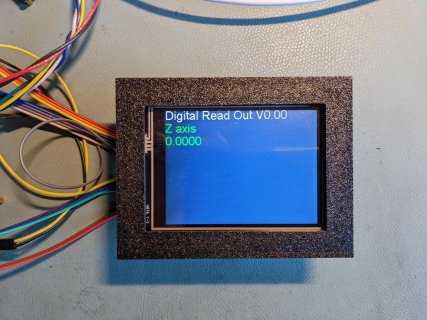

I have the larger 3.2" ILI9341 that PJRC sells. I'd like to use the display for my electronic lead screw project. Anyone know of a source that sells bezels that might fit the display?
Really want it to cover over the hole in the chassis that the display will attached to. Got any ideas?

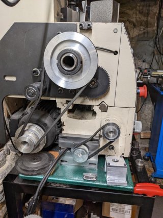

I'm in the process of installing the physical hardware, ie. motors and pulleys and belts on the lathe. Have designed it so the changes are reversible, should things go awry.

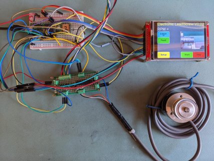

The wireless breadboard on my desk is starting to get flaky on me, in other words getting intermittent connections. Need to make a chassis and or carrier board for everything and hard connect everything. It is the only way it would survive on a lathe. If there was a bezel available, I'd like to accommodate it.

I designed one in FreeCAD, since I couldn't find one to buy. A helpful person will print it for me from ABS. Should be close enough. If not, I will alter it.
I am in the UK an can print in PLA if needs be.
TBH PLA is strong enough for most things unless its going to be in 50*C enviroment and is much easier to print.

Seems I did not account for the lip of the chip pan. I need to jack up the lathe and drill the lower two mounting holes. While I am at it, I will install some riser blocks for the lathe. This will make it easier to clean the chip pan under the lathe. The riser blocks are made of 1" (25mm) thick scrap steel. One step forward, two steps back. Eventually I will get there. Been a multiple discipline learning experience!
Just received my bezel. Due to my design error, the left side silver is visible. Next go around will fix that, but it is good enough for now!
