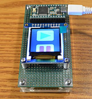

I've got a ST7735 on my desk right now. Planning to look at it tomorrow morning or Friday.
Starting with 1.32-beta2, I'm going to rename the Teensy-optimized version to ST7735_t3. Like we do now for ILI9341_t3, this will allow using Adafruit's original or easily switching between them without conflicts.
The optimized code has lagged pretty far behind. I'm going to start doing some updates, but it's unlikely everything can happen by 1.32 release.

// This Teensy3 native optimized version requires specific pins
#define sclk 13 // SCLK can also use pin 14
#define mosi 11 // MOSI can also use pin 7
#define cs 10 // CS & DC can use pins 2, 6, 9, 10, 15, 20, 21, 22, 23
#define dc A1 // but certain pairs must NOT be used: 2+10, 6+9, 20+23, 21+22
#define rst 8 // RST can use any pin
#define sdcs 4 // CS for SD card, can use any pin
#include <Adafruit_GFX.h> // Core graphics library
#include <ST7735_t3.h> // Teensy-specific library

void mediabuttons() {
// play
tft.fillScreen(ST7735_BLACK);
tft.fillRoundRect(25, 10, 78, 60, 8, ST7735_WHITE);
tft.fillTriangle(42, 20, 42, 60, 90, 40, ST7735_RED);
// pause
tft.fillRoundRect(25, 90, 78, 60, 8, ST7735_WHITE);
tft.fillRoundRect(39, 98, 20, 45, 5, ST7735_GREEN);
tft.fillRoundRect(69, 98, 20, 45, 5, ST7735_GREEN);
// play color
tft.fillTriangle(42, 20, 42, 60, 90, 40, ST7735_BLUE);
delay(50);
// pause color
tft.fillRoundRect(39, 98, 20, 45, 5, ST7735_RED);
tft.fillRoundRect(69, 98, 20, 45, 5, ST7735_RED);
// play color
tft.fillTriangle(42, 20, 42, 60, 90, 40, ST7735_GREEN);
