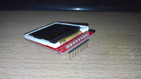

Does that display have a second set of pins on the other side? On mine, there were two sets of pins. One set had been soldered (with 11 pins), but I never could get them to work. I eventually tried the second set of pins on the other side (8 pins), and those worked with the Adafruit driver. I eventually just clipped off the first set of pins, so I wouldn't use them by accident.I found this cheap clone in my box of spare parts. But I can't get it to work with either library.![]()

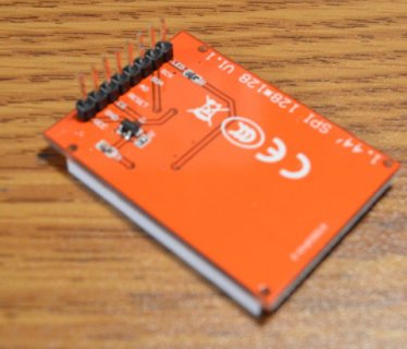

As some have already mentioned:If so it might be the BLACK header spacer version KurtE just got and last I saw it was not working for him?
@KurtE - if your looks like that you didn't get what I have.

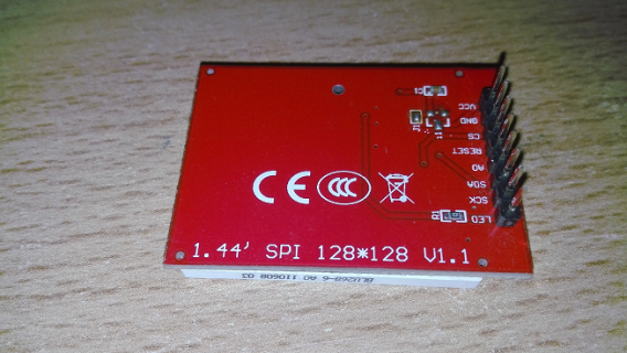

ili9163c's I got were all yellow header and the PCB has more traces up higher away from the silkscreen - the V1.1 and other silk screening is similar - except the blurry end silkscreen isn't there and I don't have what looks to be the four display corner holes.
Beware when you shop for your LCDs on eBay as sellers that were*posting version 1.1 might now be posting version 2.1 UNDER THE VERY SAME LISTING THAT SHOWS PHOTOS OF PANEL VERSION 1.1.
That linked site has such a fun summary of eBay - would be nice if they at least got a photo of what they sell:
Just to avoid disappointment, if you want to ensure your project is using the up-to-date version of the panel then I'd recommend looking for auctions where it is clearly stated "New" in the title and/or photos are given for the panel itself showing "V2.1". E.g.Nice to get good prices - but scary when you end up with counterfeit or mislabeled stuff.

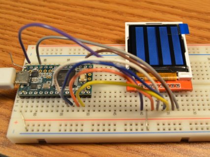

May have to take you up on it... Right now hacking up Paul's ST7735_t3 code to make it work on different busses...The eBay ones I got have as noted "outer wrap marked ST7735" - but they play perfectly with the sumotoy code for ili9163c - and images and details matched those shown on his thread, unlike the images seen here from Paul or Kurt. Kurt - I got 3 of those (whopping $13 with paid shipping) - I could send you one?

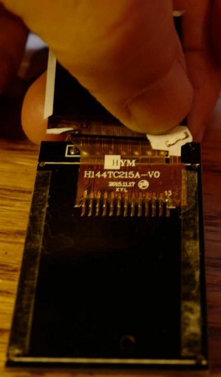

Would be nice to find a current supply of them that works. Will be interesting if anyone orders and gets a V2.1 that actually works like or as well as the old V1.1. May be different controller - but for 128x128 pixels if the controller is functional it will still be fast. Tiny but full color and just proportionately larger than mono OLED at the same $3.50 it is generally a better device.

I got recently a couple of 128x128 V2.1 RED PCB, Yellow PIN but surprise....not using the ILI9163C but ST7735...
and keep getting compile errors.
