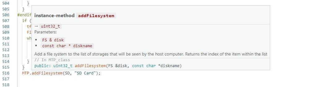

6) Stability issues with Language Server. This is the code that when you hover over something, it will show you something like:
Makes me want to go in and edit some of our header files and add more details.
Issues include: https://github.com/arduino/arduino-ide/issues/1042

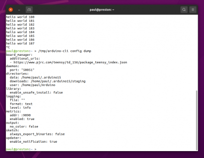

Now how to do I compile a sketch: first attempt (actually probably 10th) :
Note: one of my first attempts failed to find any of the libraries. Turns out the CLI does not look into the same configuration stuff as either IDE... And it was defaulting to default location which is under the onedrive... on my W11 machine. My sketchbook is not there. So fiddled around with it for a while and found:
arduino-cli config init
Then edited the file mentioned and set the correct location.

Is there a way to make arduino-cli download all supporting files by adding an url to the "cli-config.yml" file, as done for the esp8266com?
board_manager:
  additional_urls:
    - http://arduino.esp8266.com/stable/package_esp8266com_index.json
or can the files / libraries be installed manually ?
