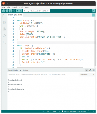

@PerT @Paul @mjs513 and all.
I installed today daily build as well on W10...
I started off with simple sketch:
  pinMode(13, OUTPUT);
  while (!Serial)
  Serial.println("Start of Echo Test");
  if (Serial.available()) {
    digitalToggleFast(13);
    Serial.print("Received:(");
    int ch;
    while ((ch = Serial.read()) != -1) Serial.write(ch);
    Serial.println(")");
Built it for T4.1 Serial type USB. Built and programmed Teensy 4.1
If I choose the Teensy Port (Teensy 4.1 at usb:0/140000/0...)
And I type anything in serial monitor and hit <Ctrl>Enter
Nothing shows up and the LED does not change state.
If I instead choose: Teensy 4.1 at COM27 Then I do get the data... And the LED flashes.
But: If I Serial print something, then it appears like then I do receive the Serial Input... That is changed sketch to:
elapsedMillis em = 0;
uint32_t alive_count = 0;
  while (!Serial)
    int ch;
  if (em > 5000) {
    // If I Uncomment the print below it echos???
    Serial.printf("Alive Count: %u\n", ++alive_count);
    em = 0;
And I then on the Teensy port selection receive data after a delay until the next Serial output. No delay with COM27
I created new issue on this one: https://github.com/arduino/arduino-ide/issues/1072

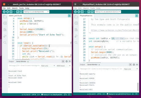

Seems to work when I try with the latest nightly running on Linux.
Just checked on the Pi4 as well and only one port gets enumerated as opposed to the 2 in Windows for the Teensy 4.1
Sketch is a bit different but same idea. Its reading a GPIO pin on the PI4 and telling me data is ready when it sees a pulse. I can check with the posted sketch but don't think it will be an issue
NOTE: the PI4 is only available for release sketches so this is using rc7
Looks like I can get 2 windows to talk to the same port. Seems each window has its own port selection, which is different from Arduino 1.8.x, and of course IDE 2.0 has no way to know that different pluggable monitor utilities will end up trying to access the same hardware.
I just tried also on RPI4 with RC7 and it appeared to work OK there...
Edit: It also appears work on on MAC
Just checked on Windows and does the same thing as you showed

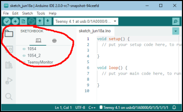

First run of the nightly build. It was sort of interesting that the sketches tab was empty.
By "sketches tab", do you mean the "Sketchbook" view in the left side panel?:
Clipboard02.png​
I closed out the windows. I then ran it again and this time the Sketchbook tab is populated.
Never sure if this is something to report or not... Maybe it was a fluke. Did not notice any Issues on this, but maybe not the right search terms.
High quality unique issue reports are always welcome.
Yes that is the area...

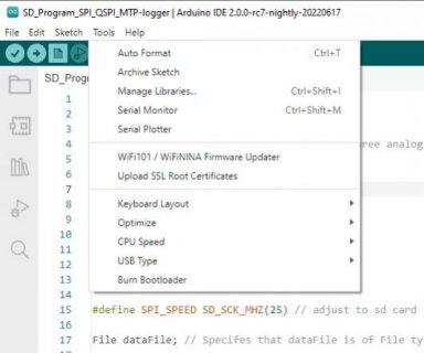

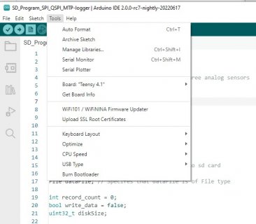

I just loaded up yesterdays daily build, and may want to change the board type so I click on the tools menu.
Where are the boards... I dismiss the menu and load it again.
Oh there it is...
So then ask myself... Should I report it? ... Well seems pretty obvious so I am sure someone has already done so in the past....
Tried this just now on Linux. Both 2.0.0-rc7 and nightly-20220618 show the boards first time I click the Tools menu. Maybe it's a Windows only bug? Or maybe it's some sort of race condition where the computer CPU or storage speed matters?
But also noticed just opening the IDE, letting it load an example I had open previously, and then quitting with CTRL-Q causes it to ask me if I want to save changes even though I never typed any keystroke other than CTRL-Q to quit.
