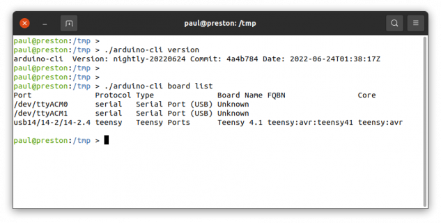

Try running "arduino-cli version"? What does it show?
When I try here with the latest, I see this:
arduino-cli  Version: nightly-20220624 Commit: 4a4b784 Date: 2022-06-24T01:38:17Z
Here's a screenshot of how it works when I use it.
@PaulStoffregen: this is my version and how it looks:
$ arduino-cli version
$ arduino-cli board list
Error initializing instance: Error loading hardware platform: discovery teensy:teensy-discovery not found
Port         Protocol Type              Board Name FQBN Core
/dev/ttyACM0 serial   Serial Port (USB) Unknown

I just tried it on my Windows machine:
C:\Users\kurte\Documents\Arduino\libraries>arduino-cli board list
usb:0/140000/0/1/4 teensy   Teensy Ports Teensy 4.1 teensy:avr:teensy41 teensy:avr
Thank you both! It is now working. I removed all configuration and started anew. I think it was a bit confused about paths.
If you find any insight about what path issues got arduino-cli so confused, please share.

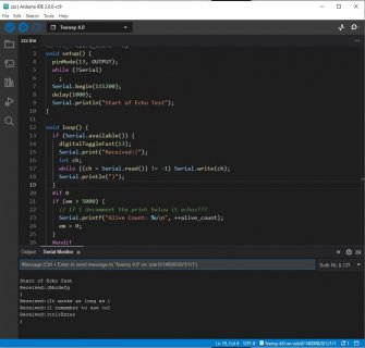

I thought I would post an update on the IDE2/CLI issues with the Pluggable Serial Monitor support and the issue I ran into:
More ore the details are up in the IDE issues.
https://github.com/arduino/arduino-cli/issues/1774#issuecomment-1175908540
Summary of issue:
elapsedMillis em = 0;
uint32_t alive_count = 0;
  pinMode(13, OUTPUT);
  while (!Serial)
  Serial.println("Start of Echo Test");
  if (Serial.available()) {
    digitalToggleFast(13);
    Serial.print("Received:(");
    int ch;
    while ((ch = Serial.read()) != -1) Serial.write(ch);
    Serial.println(")");
  #if 0
  if (em > 5000) {
    // If I Uncomment the print below it echos???
    Serial.printf("Alive Count: %u\n", ++alive_count);
    em = 0;
With the above code: if you run this on Windows, you will never receive the data. That is if you type: abcdefg CTRL-Enter
in the Serial Monitor you will not receive the data.
If however you change the #0 to #1, you will receive the data, but only when the next output happens (Alive Count printed)
Yup, it's a Windows-only issue (and yet another example of really odd WIN32 API limitations).
Here's an attempt at a fix. Extract and copy teensy-monitor.ext to C:/Users/{yourname}/AppData/Local/Arduino15/packages/teensy/tools/teensy-discovery/1.56/
I only did serial so far. Haven't touched HID yet.
  • teensy-monitor-serialfix.zip
It works :D
