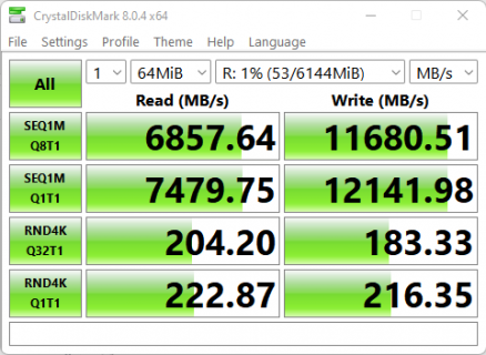

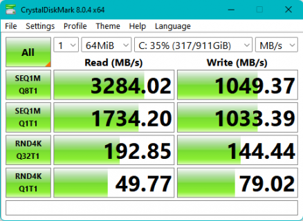

Is configuring your temp folder on a normal drive an option?
