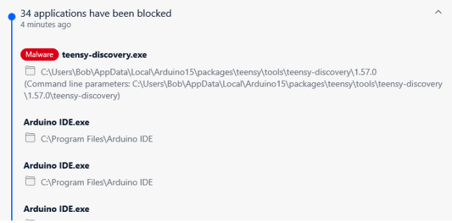

An ACTUAL error this time. Attempted to use Arduino 2.0 with the above .json and BitDefender threw the following hissy fit
It stopped everything working, then re-booted and cleared things out in the process.
Had similar issues with Norton but I put the directory on the exclude list. Maybe that will help.
Thanks I will give it a go next time, for the moment I have gone back to Arduino 1.18 / Visual Studio + Visual Micro.
