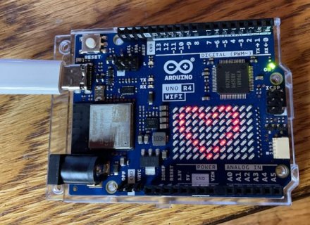

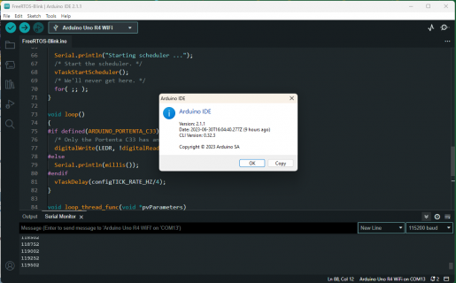

Quick FYI - Arduino released a new version today 2.1.1, which I have downloaded and installed.
So far I have only tried it on:
Which appears to work. At least an example for the matrix led worked as well as a Wifi example.
Installed 2.1.1 here and it works on T 4.0 and 4.1 ... just opened and built and uploaded. Two copies of USB-SerialPrint-Speed Test and both running in separate IDE windows SerMon at 500Klines/sec
Going to edit my multi Teensy issue ... it worked once to program 4.1 then 4.0 with both connected for above sketch. Then opened prior sketch and it gets confused and RED LEDS 4.1 when code for upload to 4.0. ... maybe a clue ???
That is strange....
resolved ... did a restart and running from saved shortcut opened 2.1.0 and then update completed.
