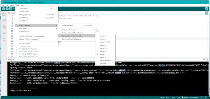

I got a working Windows Verify build with:
View attachment 27356Code:Version: 2.0.0-rc3-nightly.20220128 Date: 2022-01-28T03:03:44.410Z CLI Version: 0.20.2 [13783819] Copyright © 2022 Arduino SA
After Verify it opened Teensy Loader and passed the name, but Verify only.
Builds HEX and eHex for T_4.1 and Teensy Loader works
Just put TD 1.56 into "C:\Users\Tim\AppData\Local\Arduino15\packages\teensy", removed a path '..', and changed a lot of '/' to '\', and added explicit ".exe" as needed in the Boards and Platform TXT files - and restarted IDE 2.0.
IDE: Slow to load, no windows text resize, SerMon window is hard DOCKED and won't float to a stand alone window.
SerMon ID's Teensy as 3.1/3.2, and keeps needing it reselected to connect.
Arrggh: Everything in ARDUINO15 folder means harder to copy, and only single install?
Upload has a PATH making glitch - not doing 'macro' replacment for this .path?:
Code:Compilation complete. "{runtime.hardware.path}\tools\teensy_post_compile.exe" "-file=BlinkWithoutDelay.ino" "-path=R:\TEMP\arduino-sketch-57B791B5A63BFE52DB74090D946EF1E5" "-tools={runtime.hardware.path}\tools" "-board=TEENSY41" -reboot "-port=COM45" "-portlabel={serial.port.label}" "-portprotocol={serial.port.protocol}" Upload error: Failed uploading: cannot execute upload tool: exec: "{runtime.hardware.path}\\tools\\teensy_post_compile.exe": file does not exist

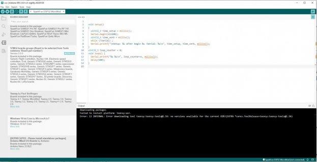

Note: I installed nightly on windows (earlier on Ubuntu, then edited the extra boards, reloaded and tried to install:
Directory of C:\Users\Tim\AppData\Local\Arduino15\packages\teensy
01/28/2022 01:29 AM <DIR> .
01/28/2022 01:25 AM <DIR> ..
01/28/2022 01:22 AM <DIR> avr
01/28/2022 01:29 AM <DIR> tools

Just to confirm, 2 of the tools are completely different implementations for Arduino 1.8 vs Arduino 2.0 & arduino-cli. When Arduino merges #1640, I will be adding code to specifically check for which version of Arduino we're using and whether it is running with a GUI or headless.
So there's not much value to testing by kludging the tools designed for Arduino 1.8 into use on Arduino 2.0. By doing so, you may discover problems which will be present with the properly updated tools, but you'll probably encounter all sorts of issues due to using the not-meant-for-2.0 tools.
I got the Wincows multithreaded discovery tool to compile this morning. Will begin testing here this afternoon (at the moment, Robin & I are working on PJRC business stuff.... can't spend all hours programming). Hopefully by tonight I should have a feeling for whether the Windows stuff is going to be "soon" or "troublesome".
