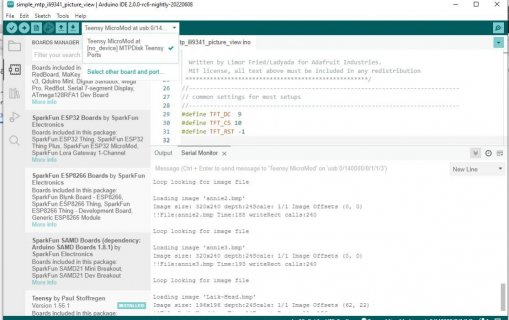

Morning all, I tried downloading nightly build.
First attempt: downloaded one dated for 0607, things ran like before... So could not connect the MTP Disk with the serial monitor.
Then noticed new version 0608, downloaded it
And now when it launches it looks like the MTP disk will connect to Serial monitor, but could not compile,
Then open up Boards tab the list was empty. Opening the Library tab again empty...
This was W10. Trying now on Ubuntu 22.04 still downloading...

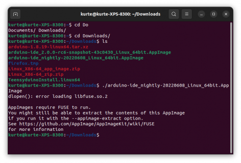

Nightly on Ubuntu... I think there is an issue with 22.04 support...
Now need to figure out how to make it work
EDIT: See there is an open Issue: https://github.com/arduino/arduino-ide/issues/984
EDIT2: Resolved by: sudo apt install libfuse2
But hopefully they resolve the installs such that users don't have to guess and do something

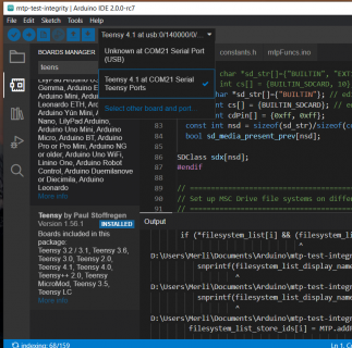

As of 6:21EST it has been released just updating now. Seems to be working nicely - alot better than prior releases:
NOTE Compile errors are due to not having beta2 installed. Left it at 1.56.1 intentionally
Installed on both W10 and Ubuntu 22.04.

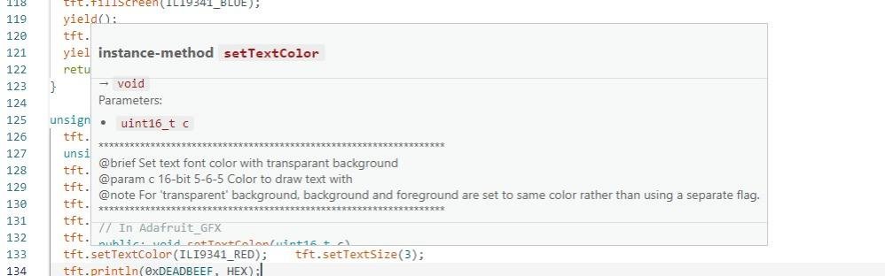

So far it looks like you are adding simple comments.
Whereas Adafruit has things like:
    @brief   Set text font color with transparant background
    @param   c   16-bit 5-6-5 Color to draw text with
    @note    For 'transparent' background, background and foreground
             are set to same color rather than using a separate flag.
  void setTextColor(uint16_t c) { textcolor = textbgcolor = c; }
Which is used by the docgen...
But looks like the IDE does not parse it, but simply displays as is...

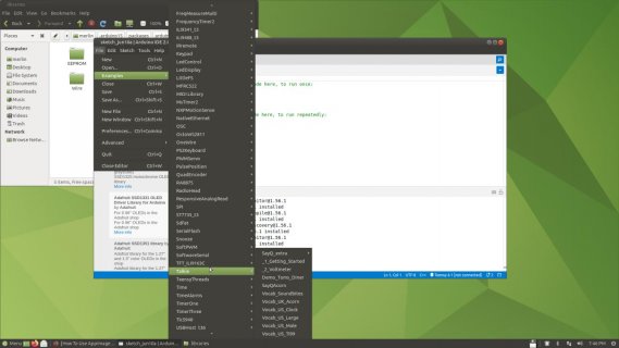

Had to redo a bunch of reinstalls on the PI4 and wasted time with the M2 memory drive on the PI4 so ..
Just finished reinstalling IDE 2 on the PI4 using the appimage route and installed the Teensy boards without any issue but noticed something else strange. When I went to file examples for the T4.1 looked for our SD Library on the list it wasn;t there - maybe it was my eyes but here is a screen grab
@mjs513 - open a known SD sketch and build - then check console to see if it is using the right SD library for Teensy?
If IDE 1.8.19 for instance links to a lib from 'sketchbook\libraries' it won't show examples for TeensyDuino libs.
So it may be getting wrong precedence and picking the default SD lib {normally 'Not used'} - or one from sketchbook?
Used: C:\T_Drive\arduino-1.8.19\hardware\teensy\avr\libraries\SD
Not used: C:\T_Drive\Arduino-1.8.19\libraries\SD
Probably as Defragster mentioned and as I mentioned up above and in https://github.com/arduino/arduino-ide/issues/1039
The IDE on first run downloads several libraries into the <sketcheds>/libraries folders including SD.
And if that version has examples it would probably show up in the early section of the examples...
