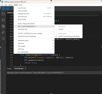

I opened a sketch. This sketch was last used on a different board. in this case, an Arduino Nano 33 IoT:
I then decided I wanted to build it for Teensy 4.1, so I turned on the Teensy 4.1 and then selected it from the Toolbar drop down list.
Something like:
I then rebuilt the sketch for the T4.1, which uploaded, but the Serial monitor was empty (was not showing anything.)
I then chose the Serial port version (not Teensy from the Tools->Port menu as shown in previous picture and the data showed up in Serial Monitor.
I then went back and selected the Teensy Port item in the list and again the monitor window was empty.
But then I rebuilt the sketch again, and after it rebuilt the output was showing up properly in the Serial Monitor.

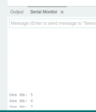

Looks like it is starting and printing ... but IDE is not refreshing the visible portion of the SerMon frame?
STEPS to see it work - Click Upload and switch to 'Serial Monitor' tab soon after upload completes and 'Output' tab updates are complete.
> if viewing while output is active it will be there
STEPS to see confusing output: No visible output but LED OFF - all Serial.print()'s will be completed:
> allow upload to complete and after restart LED ON then OFF
> Switch to 'Serial Monitor' tab - and it is BLANK
--> scroll down and GUI SerMon output draws and displays.
// So the Output has been captured and cached - but without active output the IDE SerMon tab is not updated.

Then as above changing from Output to SerMon tab - it is as above BLANK until scroll action in the SerMon tab Frame.

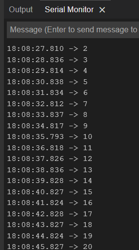

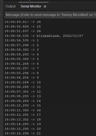

Using a 2.0.2 with the updated teensy_monitor (from the other thread), using a Micromod on a windows 10 and using Serial Port and not Teensy port I am able to duplicate the issue:
As a experiment I left the IDE's Sermon open and re-uploaded the sketch and it did pick up the missing prints:
As a second experiment I added a delay(1000) after the while loop just out of curiousity and that seemed to work:
and one more test. Just used while(!Serial) and the delay(1000), still seemed to work:

Do Ctrl+U with code below, watch for LED to start blinking before switching to 'Serial Monitor' tab:
See the BLANK spot instead of the sequential output? This happens with or without 'delay(1000)' in setup().
Then hit the mouse wheel 'scroll' and - there it is:
[B][COLOR="#FF0000"]C:\T_Drive\tCode\FORUM\serialIDE2test\serialIDE2test.ino Nov 30 2022 20:52:07
run secs A=7.99
run secs B=7.99
See Me: 1
See Me: 2
See Me: 3
See Me: 4[/COLOR][/B]
See Me: 5
See Me: 6
See Me: 7

Created: github.com/arduino/arduino-ide/issues/1724
Added this note:
HINT Perhaps?: It is as if the output was displayed and scrolled down - only the tab was not in focus. So the 'scrolled view' 'shows' the
 lines that would have been displayed had the window scrolled down - but the tab window is instead at the top, so the 'offscreen' content
 was clipped.
