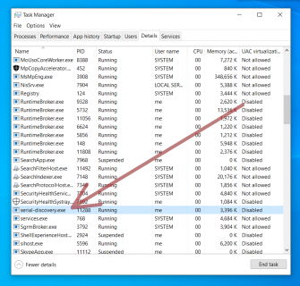

I'm continuing to investigate this problem. Seems like something is causing Windows WM_DEVICECHANGE messages to be delayed or sometimes not arrive at all, which plays havoc with teensy-discovery.exe and teensy-monitor.exe ability to observe arrival and removal of USB devices.
At least for the 1 case I can reliably reproduce on my Windows test machine, using Task Manager to kill the serial-discovery.exe process seems to solve the problem.
@Defragster & anyone else seeing this issue, please try killing that process and let me know if it solves all the problems, or only some, or none?
Obviously this isn't a good solution, but right now my goal is just to learn more about what's causing the problem. Feedback about how this changes things on other Windows systems would really help.

KILLED serial-discovery.exe and IDE 2 with "PJRC Teensy Ports Serial Monitor" running "that sketch":

How do TeraTerm and Putty handle unplugging the USB cable while Teensy is connected? Do they consume excessive CPU and/or get stuck?
Neither one. Monitoring CPU usage shows about 0.2% CPU usage normally. Then when disconnecting or connecting CPU usage jumps briefly to 6.7% and drops back to 0.2%. In the case of Putty, the session stops and has to be restarted. TeraTerm just continues on it's merry way. It does not disconnect it seems.
Ok, got it. Turned off Serial in TyCommander uploaded the sketch without failure. Then enabled serial and "Begin Program" was displayed.
