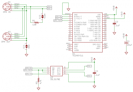

/* DmxReceiver - DMX Receiver for Teensy 3
Copyright (c) 2014 Jim Paris
Copyright (c) 2014 Ward
Permission is hereby granted, free of charge, to any person obtaining a copy
of this software and associated documentation files (the "Software"), to deal
in the Software without restriction, including without limitation the rights
to use, copy, modify, merge, publish, distribute, sublicense, and/or sell
copies of the Software, and to permit persons to whom the Software is
furnished to do so, subject to the following conditions:
The above copyright notice and this permission notice shall be included in
all copies or substantial portions of the Software.
THE SOFTWARE IS PROVIDED "AS IS", WITHOUT WARRANTY OF ANY KIND, EXPRESS OR
IMPLIED, INCLUDING BUT NOT LIMITED TO THE WARRANTIES OF MERCHANTABILITY,
FITNESS FOR A PARTICULAR PURPOSE AND NONINFRINGEMENT. IN NO EVENT SHALL THE
AUTHORS OR COPYRIGHT HOLDERS BE LIABLE FOR ANY CLAIM, DAMAGES OR OTHER
LIABILITY, WHETHER IN AN ACTION OF CONTRACT, TORT OR OTHERWISE, ARISING FROM,
OUT OF OR IN CONNECTION WITH THE SOFTWARE OR THE USE OR OTHER DEALINGS IN
THE SOFTWARE.
#include "mk20dx128.h"
#include "DmxReceiver_CrisEdit.h"
#include "HardwareSerial.h"
#define DMX_BUFFER_SIZE 513
#ifndef UART_C3_FEIE
#define UART_C3_FEIE (uint8_t)0x02 // Framing Error Interrupt Enable
static volatile uint8_t dmxBuffer1[DMX_BUFFER_SIZE];
static volatile uint8_t dmxBuffer2[DMX_BUFFER_SIZE];
static volatile uint8_t *activeBuffer;
static volatile uint8_t *inactiveBuffer;
static volatile uint16_t dmxBufferIndex;
static volatile unsigned int frameCount=0;
static volatile bool newFrame=false;
HardwareSerial Uart = HardwareSerial2();
void DmxReceiver::begin(void)
// UART Initialization
Uart.begin(250000);
// Fire UART0 receive interrupt immediately after each byte received
UART2_RWFIFO = 1;
// Set error IRQ priority lower than that of the status IRQ,
// so that the status IRQ receives any leftover bytes before
// we detect and trigger a new frame.
NVIC_SET_PRIORITY(IRQ_UART2_ERROR,
NVIC_GET_PRIORITY(IRQ_UART2_STATUS) + 1);
// Enable UART0 interrupt on frame error and enable IRQ
UART2_C3 |= UART_C3_FEIE;
NVIC_ENABLE_IRQ(IRQ_UART2_ERROR);
activeBuffer = dmxBuffer1;
inactiveBuffer = dmxBuffer2;
void DmxReceiver::end(void)
Uart.end();
NVIC_DISABLE_IRQ(IRQ_UART2_ERROR);
void DmxReceiver::fill(uint8_t v)
__disable_irq();
dmxBuffer1[0] = 0;
memset((void *)(dmxBuffer1 + 1), v, DMX_BUFFER_SIZE - 1);
dmxBuffer2[0] = 0;
memset((void *)(dmxBuffer2 + 1), v, DMX_BUFFER_SIZE - 1);
__enable_irq();
void DmxReceiver::clear(void)
fill(0);
unsigned int DmxReceiver::frameCount(void)
return ::frameCount;
uint8_t DmxReceiver::getDimmer(uint16_t d)
return inactiveBuffer[d];
int DmxReceiver::bufferService (void)
__disable_irq(); //Prevents conflicts with the UART0 error ISR
int available=Uart.available();
int retval=available;
while (available--)
activeBuffer[dmxBufferIndex]=Uart.read();
if (dmxBufferIndex<(DMX_BUFFER_SIZE-1)) dmxBufferIndex++;
__enable_irq();
return retval;
bool DmxReceiver::newFrame(void)
if (::newFrame)
::newFrame=false;
return true;
return false;
// UART0 will throw a frame error on the DMX break pulse. That's our
// cue to switch buffers and reset the index to zero
void uart2_error_isr(void)
// On break, uart0_status_isr() will probably have already
// fired and read the data buffer, clearing the framing error.
// If for some reason it hasn't, make sure we consume the 0x00
// byte that was received.
if (UART2_S1 & UART_S1_FE)
(void) UART2_D;
// Ensure we've processed all the data that may still be sitting
// in software buffers.
DmxReceiver::bufferService();
// Update frame count and swap buffers
::frameCount++;
dmxBufferIndex = 0;
if (activeBuffer == dmxBuffer1)
inactiveBuffer = dmxBuffer1;
::newFrame=true;
