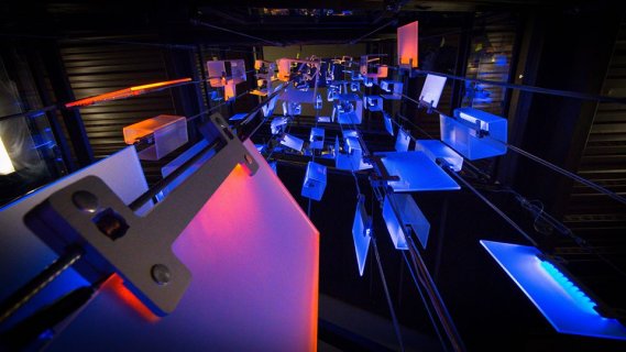

Hey, I've been working on a big project that uses the teensy and ethernet shield based off info found on this site:
http://www.epyon.be/2013/07/18/teensy-arduino-adapter-shield/
The project is called the Mariposa Chandelier, it's 40' tall and is surrounded by a staircase which has buttons along the handrail that send waves up light and sound through the installation.
More photos here: https://www.flickr.com/photos/122636297@N06/sets/
Anyway the point of why I'm on here is I noticed that occasionally the ethernet boards lose their connection and won't connect back. It's like the ethernet shield just stops working if it gets a hard power reset. The project was pretty rushed and it was pretty much just me on the technical side of things (plus fabricators and random friends and last minute help from a game designer for additional Unity3d support).
The whole project is being controlled by Unity3d for the simulation side of things. The code/project is super messy, but on my github. Lots of cleanup needs to be done. I apologize.
The core of it sends a slightly modified Artnet from Unity3d to the Teensy via the ethernet shield, 99% of the time it works, but as this is a permanent installation, I want it to be rock solid. Currently I DO have flickering if I only light up a few pixels here and there, but if I leave the top set of lamps lit, all flickering goes away.
I'm also using power supplies from illumination Supply(via pixelpusher).
I'm using Neopixels from Adafruit. There are 13 LED per lamp, 10 lamps per cable, each cable is only powered at the TOP where it connects to the board. Yes the colors to fade from white/red as it goes down the line, but the animations have been optimized to reduce this and obviously nobody looking at the installation really sees it as a problem, they think it's an "effect".
I'm looking to either replace or modify the LED controllers so that they are 100% reliable. I'm not sure if it's a Teensy thing, a hardware wiring thing or just that the ethernet shield isn't good? If I reupload the program to the teensy, all is good again. Any thoughts?

The Arduino Ethernet shield is known to be very slow. Paul made an adapter for the wiz820io board that is much faster. I've been using it with Artnet and did not notice any dropouts... Flickering can be caused by a number of things but the first thing to check is proper voltage along the strip.
Edit: wiz820io adapter: http://pjrc.com/store/wiz820_sd_adaptor.html
Oh one more thing I forgot to mention. I noticed that if I send too much data too fast to the setup that I have, it basically freezes and requires a restart, which also means reloading the software onto each board.
I'll try switching to the new wiz820 adapter, I think an all in one Ethernet+Teensy+Octows2811 board would be sweet btw. A cobbled together version works too.

Looking at the photos in the link you posted I must say that the project is a beautifully executed installation. It does not happen too often when the mechanical, electrical and electronic components of a system are integrated as well that it all blends together in such a wondful fashion. The only thing missing from this thread is a video of it!
Also in order to get the full speed benefit of the higher SPI bus frequency the WIZ820io can take you need to un-comment a line in the Ethernet library:
In file /utility/w5100.cpp the red marked line is by default commented out and needs to be un-commented:

Using the artnet sketch with the 820i, when the data rate was overwhelmed I did not get any freezing, but a random colour output in the "top end" led locations. That it, the high frame update rate or volume of data to post caused the leds at the furthest address to receive partial or no update values.
