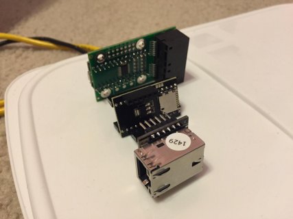

Could someone please show instructions and/or pictures on combining the WIZ820io & Micro SD Card Adaptor with the OctoWS2811 Adaptor? Is it straight forward? No pin conflicts? Just solder them together and all good?

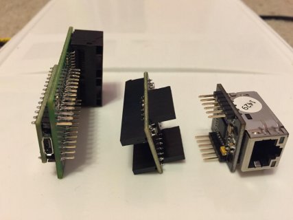

Here is my setup. I soldert my Teensy under the octows adapter. No pin conflicts and it works with Jinx.
Nice ! I assume you're not using the SD card ? That's where it could cause issues because of the shared pin.
now that is a nice clean setup. Input - Output. I have not used Jinx. What made you choose this setup for control?
Jinx is free. I'll try some other software later. And the Teensy is cheap and powerful compared to Arduino boards.

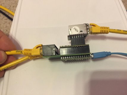

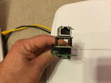

I got mine assembled too, looks slightly different as I did put the teensy on top of the octo adapter and the wiz adapter on top of that. So I got my teensy sandwiched between two adapters. :)
