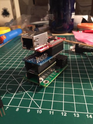

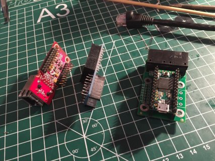

Hi everyone,
Iv been struggling for a while now and I am not getting anywhere. I have tried various codes people have posted on this forum and have no results to show for it. for instance post #329 from Titi and also other code from natal. I always get the short colour tests to the strips I'm working with but after that i can't get anywhere. I have used the basic test, fire and other example sketches from the OctoWS8211 folder and they all work fine.
My goal is to get Mad Mapper to connect to my Teensy 3.1 so i can output video data from that, to my led strips. After uploading a Sketch i go to MM and try and connect but never get any "online' Options.
Maybe someone could recommend a different program that be easier to see a connection between the devices and just give me some help in general please?

The W5100 chipset you are using is probably too slow if you want to control a lot of LEDs... You would need the wiz820io (W5200) with the wiz820 adaptor....
If you check in the Artnet examples there is an ArtnetReceive example that will just print incoming data. Did you try this to see if you were getting data in ?
Can you post your full IP configuration (IP, Subnet mask, gateway) of both your mac and Teensy ? Posting full code also helps.
Hi nlecaude, thanks for the quick reply. Ok i have ordered the wiz820 now. I did notice no one mentioned the wiz812.
Ok i have but i don't know if i have done it properly. (iv been using ardunio n teensy since the start of the year so new to it all). I have upload the Artnetreceive example and changed the it to my ip on line 15 "byte ip[] = {192, 168, 1, 67};" and thats it. Should I have something else running? how do it get the teensy to display if I am getting data in? do i use the serial monitor?

@Marc W - when you load the ArtnetReceive sketch to the Teensy, you wait till it has completed updating and then open the serial monitor. That sketch is specifically designed to view the data packets being received by the Teensy. It will spit out the data received via artnet to the serial monitor with some useful text to describe the universe and packet numbers coming in. If this sketch does not print data to the monitor you most likely have a problem with either data not being sent from your artnet data software or with the ethernet module. This is the simplest sketch to get going in the first instance.
there must be a problem with my hardware, as i have now tried it with the JV Lightning DmxControl app and the serial monitor does nothing. Ill be receiving the Wiz820 components tomorrow so ill check again when i have them.

You seem to use the same IP address on both your computer and teensy (192.168.1.67) That will not work... the computer needs to have it's own address
