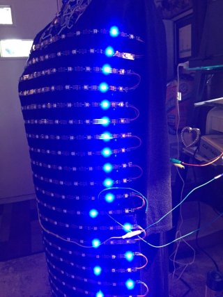

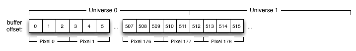

LED's shifted by 2 on second universe?
I thought I was chasing a lag/sync issue, but maybe it's just a math thing. I have a 13x22 array, split into two universes. Top one snake-line from top-left (pin2). Second one snake-line from top right (pin14). Second universe seems to be off by 1 (or two, depending on how you look at it) channel? If I start the second universe with channel 0 being the first addressed, the the first led only shows 2 of 3 colors, the second led showing the "missing" color that should have been on that first LED. And this goes on down the line.
HOWEVER -- if I shift the start of the second universe to 1 instead of 0, the second LED shows the correct color without the spread of colors to the two LEDS on either side -- problem is that the second universe is off by one pixel then ... and again on down the line.
I'm using a sketch that Cat posted earlier... Thoughts?

Ok --- tried a hardware hack since I suck at software. I physically added one pixel to the start of the second universe chain, and changed the patch to be 1 instead of 0. Works perfect now. So apparently there IS something in the code that offset by 2 channels! I COULD just leave it like it is but if someone knows where in the code the problem is, I'd be happy to eliminate this "dead" pixel hanging off then end!
chopperpix, I don't fully understand your description of what you are doing. I think it is the terminology you are using plus when you say "changed the patch to be 1 instead of 0" it's not clear to me if you mean channels or pixels. Let my try to help by stating a few basic things:
1 DMX (and ArtNet) universe has up to 512 channels (channels 0 - 511)
1 RGB Pixel uses 3 DMX channels. Not applicable here, but if you were using RGBW pixels they would likely use 4 DMX channels for each pixel.
Therefor, you can drive up to 177 pixels per universe with 2 channels left over (there's the number 2 that might be a clue). If you start with U0 Ch0, the last pixel will be on U0 Ch507, U0 Ch508, U0 Ch509. Channels 510 and 511 are leftover.
The 178th pixel could begin at U0 Ch510 and use channels U0 Ch510, U0 Ch511, U1 Ch0 and continue from there. You could also start the 178th pixel at U1 Ch0 and continue from there.
I suspect the issue is that you don't have your patch configured exactly right and that the "off-by-two" issue is related to the 2 extra channels in universe 0. Your sketch looks ok.
You've not shown us your patch so I cannot be sure. Please tell or show us exactly how the patch is configure.
Update: From studying your sketch in more depth, I'm pretty sure the 178th pixel is using data from the channel buffer which corresponds to U0 Ch510, U0 Ch511, U1 Ch0. Note that your DMX controller doesn't necessarily have to send the full 512 channels of each universe (it's not guaranteed as part of the ArtNet spec.). My suggestion is, if your DMX controller patch allows it, start the 178th Pixel at U0 Ch510. Edit for clarity: Hopefully, your controller knows to use U0 Ch510, U0 Ch511, U1 Ch0, for the 178th Pixel.
Finally to all readers, this is rather complicated, so I might have gotten something wrong. Please correct me.
chopperpix: I can't seem to leave this alone. The above diagram depicts what underlies the current issue. I hope this help us to visualize what's going on. Note that universe 1 does not start on a pixel boundary. Rather, it starts on the 3rd channel of pixel 177.
So the answer might be: Get your controller to send the data in a way that matches what your sketch will do. But there are other solutions as well. Btw, what controller (software?) are you using?
You also might find Wireshark useful to make it easy to see exactly what is being sent by the controller.

chopperpix, I don't fully understand your description of what you are doing. I think it is the terminology you are using plus when you say "changed the patch to be 1 instead of 0" it's not clear to me if you mean channels or pixels. Let my try to help by stating a few basic things: Yes, I mean channels. I started at channel 1 instead of 0.
I suspect the issue is that you don't have your patch configured exactly right and that the "off-by-two" issue is related to the 2 extra channels in universe 0. Your sketch looks ok. Really? I thought it mattered not with OctoWS2811, just was memory inefficient.
Update: From studying your sketch in more depth, I'm pretty sure the 178th pixel is using data from the channel buffer which corresponds to U0 Ch510, U0 Ch511, U1 Ch0. Note that your DMX controller doesn't necessarily have to send the full 512 channels of each universe (it's not guaranteed as part of the ArtNet spec.). My suggestion is, if your DMX controller patch allows it, start the 178th Pixel at U0 Ch510. Edit for clarity: Hopefully, your controller knows to use U0 Ch510, U0 Ch511, U1 Ch0, for the 178th Pixel. Again, if you only use lets say 30 pixels * 3 = 90 channels, you are saying that the LAST channel of U0 has to use up the last 3(or 4 depending on pixel) channels to properly map into U1?
Interesting .. Why would the pixel I added to the beginning of U0 be completely useless -- it does not light up at all -- and yet still cause the rest of the strip to be in correct sequence? Also, U0 only had 156 pixels on it. That's 468 channels - quite a way from the 512 ceiling for U0.
I think I need to understand what your patch in, I assume, your controller application is doing. What is your controller, btw? Is is an Application? Dedicated hardware? Please tell us the details. How is it configured for your LED matrix? Can you show us your patch settings?
I'll also repeat my advice about using WireShark for seeing exactly what your controller is sending. That can go a long ways toward understanding what the issue is. If you think WireShark is too complicated, let me know so that I can try to convince you that it is not ;)
