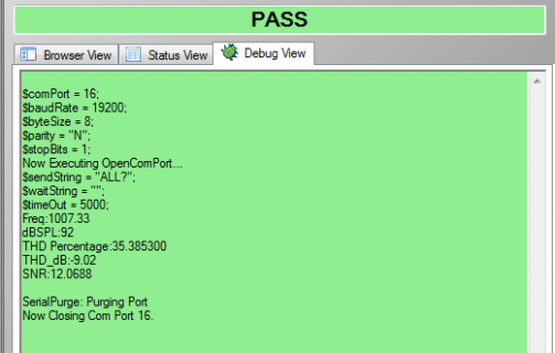

Hi all,
I'm managed to complete the audio Functional test with functions of freq, SPL, THD and SNR calculation.
I uploaded the source code here so that anyone of you able to use it when needed and also welcome to verify my source code if there is any mistakes.:)
Thank you and best regards
Alan Soong
View attachment AudioFunctionalTest.ino
And My results:
Would it be ok to add this as one of the library's examples? Should it mention your name for credit? A license like MIT or public domain?
Hoping the code would show something practical for my use with what was involved ... read it as text. Seemed like a good way to summarize the details and concepts not seen/used before:
SNR (other?) code seems to have a focus hardcoded on reference value 1000 Hz correct?
The comments are nice - but not all accurate? For example::
> level[2] = fft1024_1.read(22,25); // 86- 129Hz -> 108Hz Center
should this actually be::
> level[2] = fft1024_1.read(22,25); // 946- 1075Hz -> 1010Hz Center
SPL works across all bins, but THD and SNR only sample cusps of data? Both skip bin 2-21 then THD skips bins 25-44 (and other groups), and SNR skips bins 26-39. I'm not sure why some bins are excluded from those calculations - it seems they would hold distortion or noise data?
I liked the web link to stackexchangecircuit - was the MCP6022 used? A link to this thread might help find your dev notes.
Hi defragster,
Thank you for your comment.
1)For the freq bin comment, I forgot to amend it accordingly. (will update it soon)
2) For THD, I just figured the fundamental till 6th harmonic. Fundamental is around bin 22~ 25, that'w why I skip bin 2~21.
2nd harmonic is around bin 45~48, so in between 26 to 44 is not included on my code.
The rest of the harmonics are also configured with same method, so some group of bins are not included too.
3) For SNR, it is also using almost same method to configure. I'm using power of fundamental signal to divide the Noise power of all harmonic + noise and exclude DC component as well.
I hope that my theory understanding are in correct way. If it is something incorrect, please help to correct me so that I can tidy up these code to make it correct.
