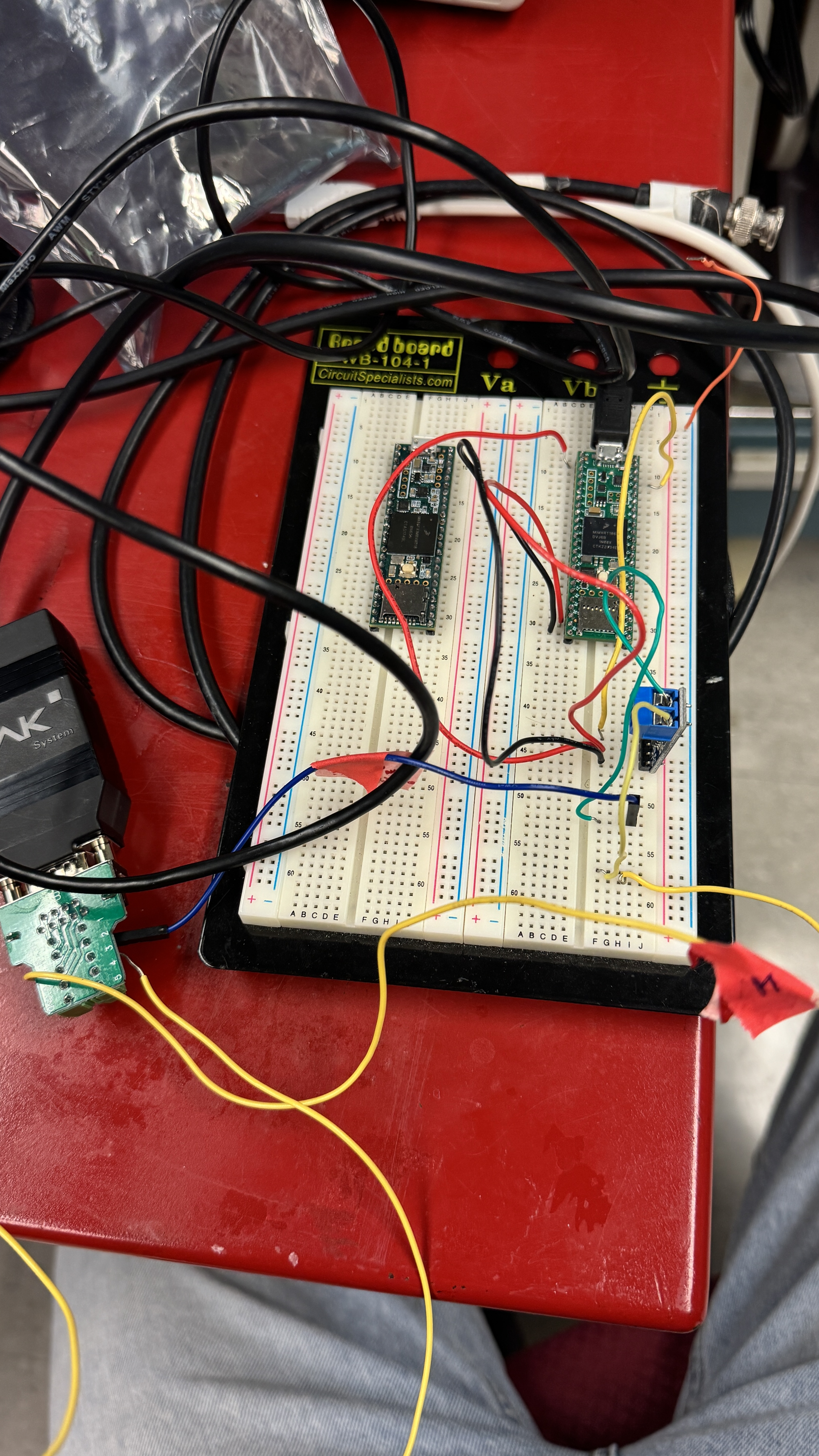

Assistance with CAN FD Communication Setup in Senior Design Project Using Teensy 4.1
First your code doesn't compile. You need to add:
uint8_t count;
Just comment out
msg.flags.fd = 1;
As can3 is already has CAN FD.
On PCAN-View you should see something like this:

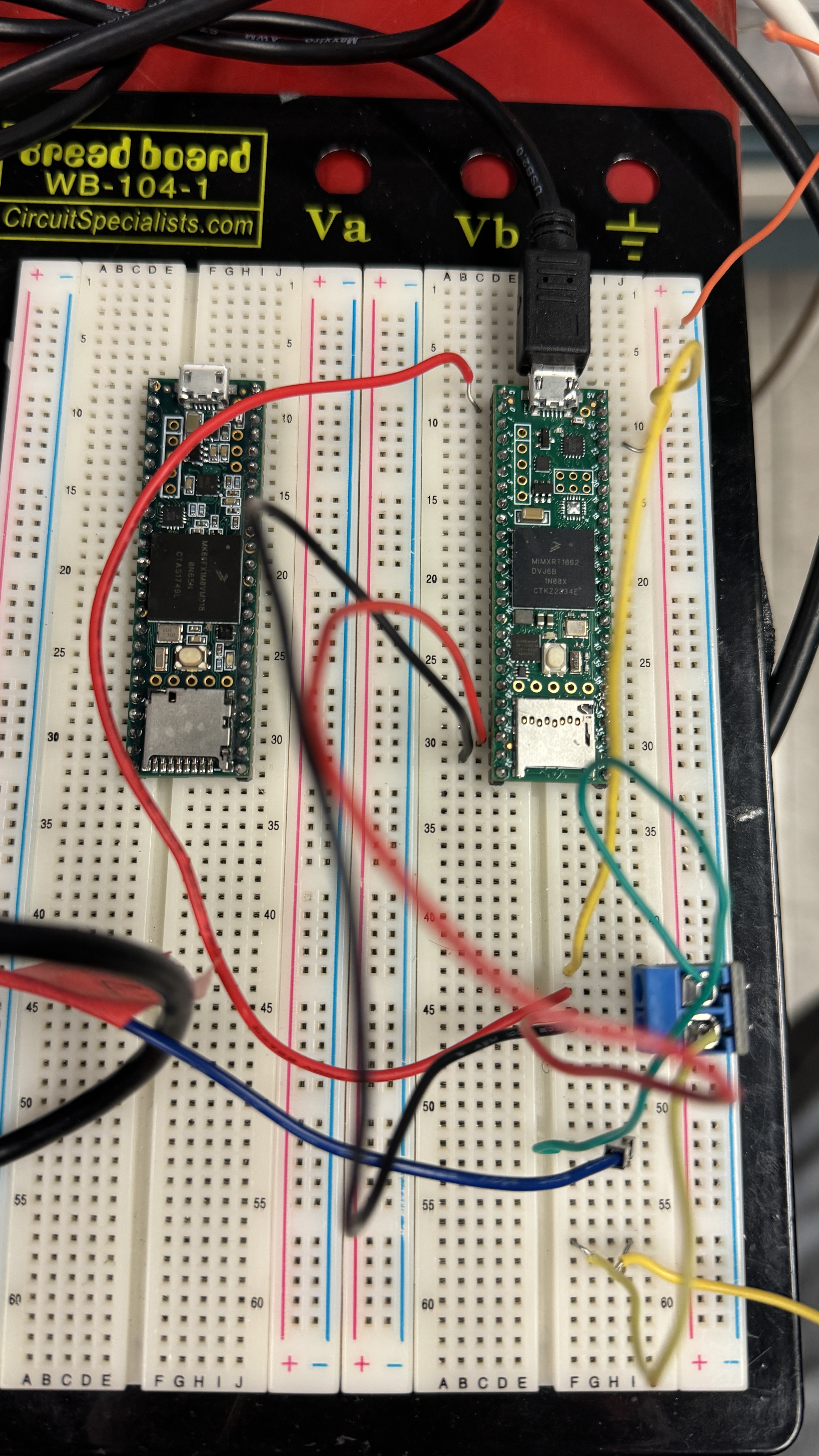

With your error on PCAN-View, it could be your wiring to the CAN transceiver is not right.
Which CAN transceiver are you using ? Is it CAN FD compliant ?
Post a photo of your setup.
Was this ran with my code. I am using the
SN65HVD230 CAN Board, DB9 CABLE and a teensy 4.1. I have posted a picture of my setup @skpang
Have you closed the terminator header pins on the CAN transceiver board ?
The SN65HVD230 is not CAN FD compliant.
You need to use a CAN FD compliant transceiver such as the MCP2562FD chip.
Yes I have closed them. What does that do though? Also before I purchase a CAN FD transreceiver can I test if can 2 or can 1 works with the current setup. Also do I need termination resistors or does the transreceivers with the closed header pins work as termination resistors ?

should this code work with my current setup? Trying to confirm logically as on pcan view I no longer see the errors made after I used a new can SN65HVD230 transreceiver as I believe the old one was faulty.
Info on CAN termination:
Best to keep using the FlexCAN_T4.h and not FlexCAN.h
Your code will then work as Classic CAN on can3 with the SN65HVD230 transceiver.
By closing the CAN transceiver does that act as a terminating resistor?
Maybe. It depends on the board.
If in doubt check. With everything powered off measure the resistance between CAN high and CAN low. If it is over 120 ohms add a 120 ohm resistor between the two lines.
CAN termination is ideally 120 ohms at each end of the bus (so 60 ohms at DC) but unless you are pushing the speed / wire length limits it is generally fairly forgiving, for a short link at 500k you should be fine with a single termination resistor placed anywhere on the bus.

Also you were right. The SN65HVD230 can transceiver works just for CAN. Do you know any can Fd applicable transceiver ?
