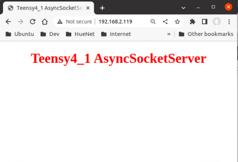

16.4.2022 Changed some code to rund with QNethernet / LittleFS / Asybc Webserver thanks to all that build that Library.
Thanks to David to give allow to repost the code.
//############## Open Points
// Download have additional Content ond big and sbig file
// No solution for uplad
// Want to akt as Webserver form Filesystem (LittelFS / Sdfat )
// Helpp welcome !
