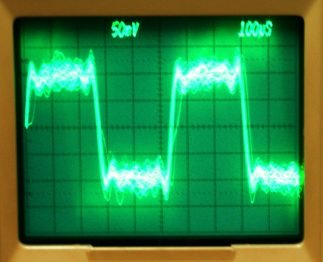

I am observing the ADC output through the DAC, with no analog input (inputs grounded). I see the following:
I have added a gain of 200 to not see too much DAC noise. The noise on the square wave is probably normal ADC noise. The p-p square wave is 200 mV for a DAC full scale of about 2 V p-p. So when the x 200 is removed, it is a lot smaller, about 1/2000 of full scale. But that is still about 8 times bigger than the ADC noise. The frequency is about 1836 Hz for a period of about 545 microseconds. It does this even with 5V applied and the PC not running (but still supplying the 5V).
The test setup is

What is this? Does anybody else see this? Am I doing something I shouldn't?
If it makes any difference, the hardware I was using was the stock audio adaptor plugged together with a Teensy 3.6. Bob

An update. This undesired square wave is at 1/24 th of the 44.1... kHz sample rate. This was determined by syncing the analog scope to the square wave and using a second trace to look at the 44.1... clock. Well, it is 1/24 a lot of the time.
Using the idea that if it would stay put relative to the 44.1 clock, I could subtract it out, I constructed an object with a square wave changing every 12 samples. Looking at the output of this and the original square wave, they stay synced for a while---sometimes many seconds, more often a fraction of a second. Then, the two jump a period of the 44.1, just like a PLL does when it is not quite able to lock. But, this means that the idea of subtracting the square wave out is more complicated, and generally flawed with transients when the cycle jumps occur. I can post code for this latter measurement, if somebody would like to observe the frequency jumping.

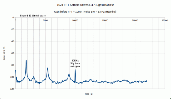

OK, I'm about done exploring this question of the SGTL5000 ADC spectrum. I have run the 1024 point FFT on the ADC output. This was done by putting a gain of 100 on the ADC output so that it covers up the FFT noise (the FFT uses integer arithmetic that typically leaves 1 or 2 LSB of data "noise".) In addition, I introduced an external signal from an HP33120A generator, normally at 10 kHz, to show that A/D conversion was occurring. This signal is weak enough to not contribute any noise of its own. The output for all 512 bins was taken through Serial.print by only taking 1 out of 150 FFT's. This was put into LibreOffice spread sheet, producing the plots here. The spread sheet converted the voltage to power, averaged 40-powers for each frequency, converted this to dB and scaled the result to a full 16-bit input.
I ran a bunch of different sampling rates, using Frank B.'s divide/multiply constants. First, here is the plot for 44117.65 rate
It shows the square wave at 1838 Hz as three components, the fundamental, third and fifth harmonics. Apparently the higher odd harmonics are hidden in the noise, as the 7th bump suggests. In any event, this is the expected spectrum. Comparing these spectral spikes with the 10 KHz shows that they are somewhat broader in spectrum than a good sine wave. The spike at 1838 is more than 70 dB down from full scale, and as pointed out before really a small disturbance. I did not try to add up the powers, but it appears that the ADC is meeting its specs with some margin.

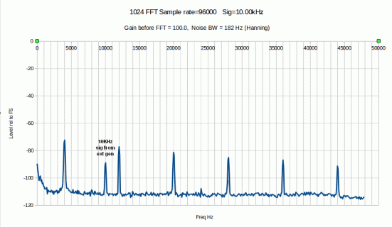

What is notable is that there are spectral regions that are really quiet. This is really shown by running the sampling at 96 kHz:
The region below 4 kHz is very quiet. For communications applications, the region from 12 to 20 KHz is very quiet, as are higher regions. This rate should be useful up to 40 kHz. Also note that as the sample rate goes up, the FFT noise bandwidth is also. So the base noise at the 96 kHz rate is around -110 dB, which is lower than at 44 kHz by perhaps 5 dB. But, it is really better on a dB/Hz basis, that is often the best measure. Adjusting for the sample rates, this makes an additional 3.4 advantage of 96KHz in dB/Hz.
I looked at other sample rates. I could not get output for 192 or 176.4 kHz. Low rates like 16 KHz are noisy and put the square wave at a bad spot.
