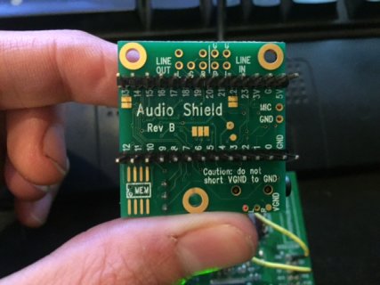

I recently bought a few of the Audio Adapter boards to have a breakout for the SGTL5000. I'm having trouble talking to it at all and can't seem to even sniff out the I2C address using my bus pirate. I've tried powering it by both 3V and 5V as well as with pull-ups enabled and disabled on the bus pirate. Is there some reason why using the Adapter Board without a Teensy wouldn't work? Any advice would be greatly appreciated. Thanks

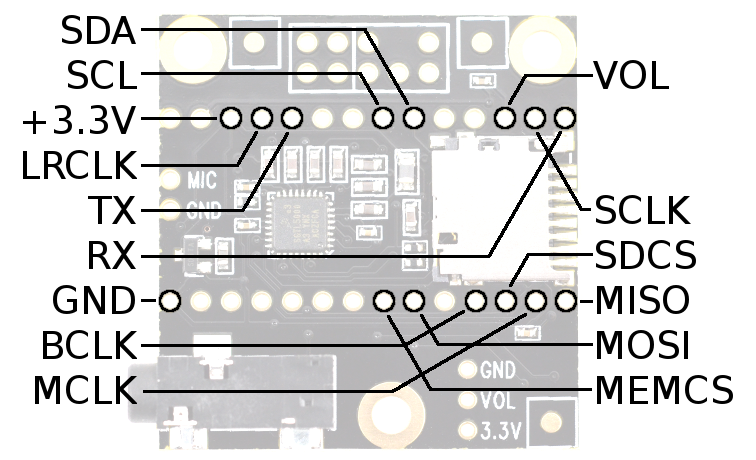

To get it talking by I2C, you only need to connect 4 wires:
3.3V
SCL
SDA
GND
SDA & SCL have 2.2K pullup resistors to 3.3V, so you don't need to add resistors.
Edit: The 7 bit I2C address is 0x0A, because the ADDR pin is wired low. Make sure you're talk to address 0x0A.
Thanks for the assistance Paul. I tried 3.3V first without pull-ups and triple-checked my pins with the pinout you've attached. Who knows why it didn't work then, but I subsequently tried 5V so it looks like I might not get to the bottom of this just yet...Regardless, next time I'll just order one with a teensy :) Still, I'm not exactly new to this stuff so I can't imagine why I struggled to get it to work the first time around. Thanks again for your help
I just noticed the bottom of my board looks a little different than the one shown on your product page. Is this an older revision or something, and if so, did it have any pinout differences? Thanks again for your help.
That's the new version. The pinout is identical. You can find both schematics and an explanation of the differences on the web page.
