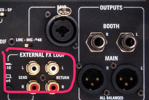

Hi, i use the teensy audio board and with the -10db instruments and it works fine
code:
sgtl5000_1.lineOutLevel(13);
sgtl5000_1.lineInLevel(0);
but i have more distortions if i connect +4db instruments, there is trick without hardware modifications?
thanks
Dani
I'd use a passive ca. 1:20 voltage divider before sending +4dB signals into the sgtl5000, something like either a 47k : 2.7k.
Or use a logarithmic 50k pot
You're going to need an amplifier to increase the output beyond the roughly 3Vp-p maximum output. The SGTL5000 simply can't create a higher voltage signal.
The basic non-inverting gain circuit should work.

when
sgtl5000_1.lineOutLevel(13); (max) 3.16 Volts p-p
sgtl5000_1.lineInLevel(0); (max) 0: 3.12 Volts p-p
when teensy audio board works at -10db, input and output have the same volume.
if the switch on the mixer is set to +4db i have a clipping input when the mixer goes to 0db. I must to use the output faders at max -4 or -3.
with a resistor the input and output aren't the same, the volume is different because i must to amp the output (for input resistor compensation).
So because some mixer haven't -10db or +4db and works at +4db only, i can't use a audio board correctly.

From searching the internet I deduce the +4 and -10dB are really +4 and -10dBV
@danxdj
+4 dBV is ALWAYS 1.58V_RMS (dB IS first of all ALWAYS ratio of POWER, therefore RMS, independent of reference)
but 1.58V_RMS is 4.48 V p_p, overloading the SGTL5000
@danxdj
ok it can be true! it happens this i think :)
in this case how can reduce input v p_p and amp output v p_p with a good sound quality?
Typically +4 dB professional audio means +4 dBu, which is 1.23 Vrms (for a sine wave), which is 3.47 Vp-p.

Look, if you're using professional quality mixers, just feed the signal into your mixer and turn the channel's gain up (or down) to amplify (or attenuate) the signal to the required levels.
Easy, right?
I use ONLY professional quality mixer like RANE, UREI, BOZAK ecc
Not, loop connection need same output volume from the efx that mixer send to input of efx... loop connection haven't a gain...
