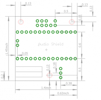

Audio board mechanical drawing
Sanworks
Hello
I'm trying to mount a Teensy audio board to a project enclosure.
There are 3 large gold-plated holes, perfect for 4-40 screws and stand-offs.
Is there a mechanical drawing of the board somewhere, that I can use to place matching holes in my enclosure design?
Thanks,
Josh

No guarantee that it is 100% correct.
Eagle-Library:
  • Teensy_Audioshield.zip

Rev D Audio Board PCB Library
I want to embed a RevD (Teensy 4) audio board in my pcb project. Does anyone have an Eagle library file for this board?
Joe
Audio Shield Eagle Libraries - RevC and RevD
Here's an updated Eagle library with both Rev C and Rev D options of the Audio Shield.
