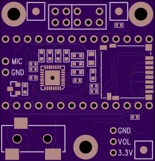

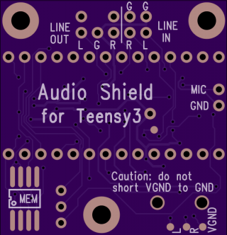

Here's what the audio shield will probably look like....
http://oshpark.com/shared_projects/2k03eMcK

The optional "MEM" chip on bottom side is meant to be a W25Q64 or W25Q128 flash memory, for storing short sound clips or (maybe) wavetables.
Is this memory able to provide ~5.4MB/s random access (4 bytes / read)? That's what's required for 32 channel 16-bit stereo mixing at 44.1KHz. From datasheet I saw it's able to do 50MB/s continuous but didn't see random access performance.
Edit: Actually double that if you do linear interpolation, so 10.8MB/s (8 bytes / read)
The W25Q128 is capable of pretty high speeds, but the SPI port on Teensy3 is limited to 24 Mbit/sec, so 3 Mbyte/sec is the absolute maximum possible speed. Each random access incurs an overhead of 4 bytes, but then may read any number of sequential bytes at the full speed.

looks as if that W25Q128 is the same footprint as the 23LC1024, so i figure it will be possible to try these out, too. nice.
Yes. In fact, I made a special SOIC-8 footprint that (hopefully) can accept the wider W25Q128 or the narrow 23LC1024.
