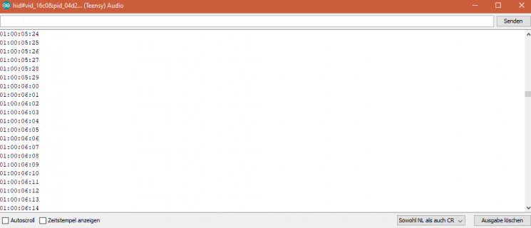

Ok, current status is:
PC plays the wav-file (Thanks to defragster!!) , a Teensy 3.6 is connected via usb-audio.
The code can decode backwards played files, and adapts to different speeds or (in theory, untested) fast-forward or fast-rewind.
It's a "ino" now (which displays the timecode above), and I have to convert it to a audio-library object.
I'll do this in the next days.
I did not use any existing code. License will be MIT.
Maybe I do encoding, too (after you have tested the decoder)

FrankB back in action and doing impressive good work in short order! Glad to help - just a simple BING search and the [BEST] link was the first result!
Wow Frank. I'm super impressed! You made it seem easy.
