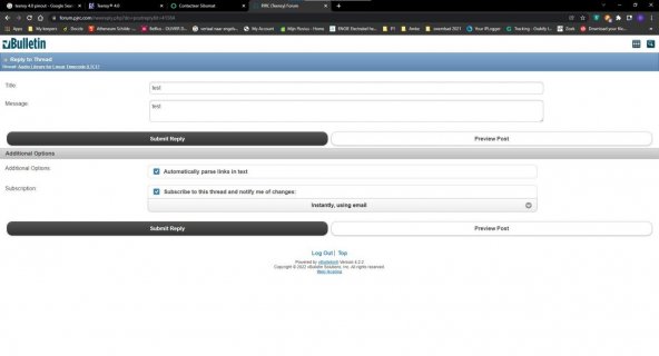

Could you place your code between code tags using the # button.
It makes the code much more readable and therefore more liable to get some help.
I'm really new to forums. Could you explain a bit more how to do this? Is it a button somewhere on the forum, or do I add # before I paste the code?
New to this? You've been a member since Nov 2018.
When making a post, when you want to add some code, press the # button above.
Type or paste your code between the [ CODE][/CODE ] tags generated.
Alternatively type or paste your code, highlight it and then press the # button and your code will have the tags placed before and after your code.
I'm using Chrome on a windows10 machine. It does not show these options. (see screenshot) changed to Explorer, it shows them.
