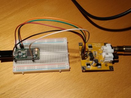

Hooked up a PCM5102 board to a Teensy 3.1 to form a USB audio interface.
With the code below, my windows PC sees a USB Teensy Audio device and outputs audio via the PCM5102 board as expected.

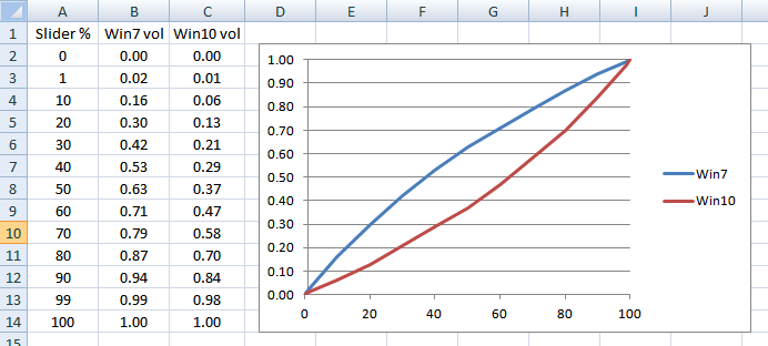

Now the interesting part is that when the slider is at 50%, the value of variable "vol" = 0.63. I expected 0.50.
When I checked other slider settings, I see the following values for slider percentages:
My questions now are: where [and how] is this conversion done? And is there a reason it isn't linear?
