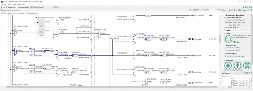

@Chris O. this is interesting stuff. I downloaded MCUXpresso Config Tools, and that (plus the i.MX RT1060 reference manual) has thrown a little more light on how clocks are set up. So the manual says PLL4's output frequency = Fref * (DIV_SELECT + NUM/DENOM), where Fref is the 24MHz reference clock.

which is (15250 + 2/7) * SAMPLE_RATE_EXACT. In your example we have 722,534,400 = 2^14 * SAMPLE_RATE_EXACT -- that power of two makes a lot more sense than what appears to be happening in i2s setup. Have you any idea why Teensy sets the audio PLL up with this frequency be?

I think you miss calculated something here: 24000000 * (28 + 224/10000) = 672,537,600
-- Freq 44100 -- OSC_24000000Mhz *(28 + (2240/10000)) = 677,376,000
c0 DIV 28
c1 NUM 2240
c2 DENOM 10000
n1 PRED/ 4 -- 677,376,000 / 4 = 169,344,000
n2 PODF/ 15 -- 169,344,000 / 15 = 11,289,600MHz
-- MCLK--11,289,600MHz
I cannot exclude that possibility.
Thank you very much for the screenshot; that really clears things up. I wasn't taking account of SAI1_CLK_PRED and SAI1_CLK_PODF. So, as far as I understand, the output frequency of SAI1 should be (256 * MY_TARGET_FS).

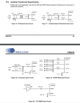

I noticed on an old thread some discussion about external clocks. The discussion suggests using the teensy SPDIF hardware input as a word-clock input. https://forum.pjrc.com/threads/60914-ADAT-white-noise-on-Teensy-4-0?p=239884&viewfull=1#post239884. It sounds like BNC is more "consumer" level and AES is considered "pro" level; because BNC is single ended and AES is balanced (for longer runs). afaik...
I found a discussion on diyaudio that referred to a schematic on the CS8416 datasheet.
There is another reference to the Twisted Pair Audio S/PDIF 4:1 MUX/RECEIVER MODULE.
So the conversion from AES to single ended is either via a transformer or a digital line receiver ("The two of the usual suspects for this job are the 26LS32 and the SN75176"). Or in the case of a single ended clock it can be a simple RC filter. Then the single ended input is fed into the Teensy SPDIF input. That makes it pretty simple stuff in hardware! Then there is the small issue of configuring the Teensy to use the SPDIF input as the word-clock. :p
See thread linked above for some ideas on how to make it work with the existing SPDIF Slave object (audio tool / github by Frank Bösing) code.
