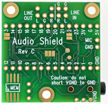

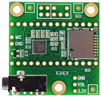

The Teensy3 Audio Board, available and in stock as of Jan 3, 2014, is the primary hardware intended to be used with this library. It's also possible to use PWM output and ADC input.

Speaking of I2C and the Audio add-on shield, does the add-on board have the 4.7K pull-up resistors for I2C? If so, if I have other I2C devices, would I still need my own pull-up resistors? If it doesn't have the resistors, I assume we would need to add them to talk to the audio components?
Yes, it has 2K pullup resistors on SDA and SCL.
The 2K resistors on the audio board ought to be plenty if you connect other I2C devices.
I should mention the actual audio data is sent using I2S, which is entirely different than I2C, even though the first 2 letters are the same.
(edited, typo fixed)
I2C uses 2 signals: SDA and SCL.
I2S uses 5 signals: 3 clocks (LRCLK, BCLK, MCLK) and 2 data pins (TX, RX).
The I2C and I2S ports are completely independent and can work simultaneously.
