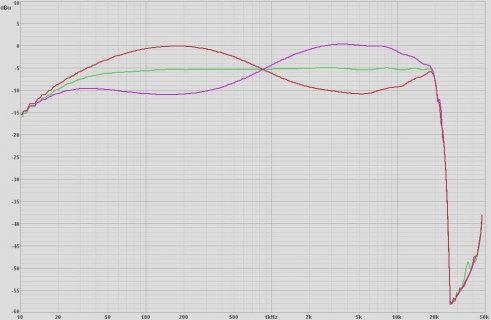

OK, swept at last. The filters look good, the SGTL5000 applies all 7 biquad filters to both channels and the AudioFilterBiquad is only being applied to the right channel (or was it left channel and I accidentally swapped sides :eek:) - both look as they ought on the sweeper when it tests the right channel.
There is a little 'wobble' in the gain-intensity between ~4Khz and ~20KHz but the TWR-AUDIO-SGTL I was using had the same 'feature' when I swept it, it is there with no filters in play as well. It is not easy to perceive using human hearing anyway. The sweeper is using 96KS/s and sweeps to 48KHz, the SGTL5000 has a low pass @~20KHz but it doesn't attenuate well above ~23KHz but only a pathological audiophile with the hearing of a child might care.
The attached sweep is line-in thru I2S to DAP to line-out, right channel only. I changed line out level (CHIP_LINE_OUT_VOL) to 0x0808 for this sweep to make the parametric EQ max gain drive output to max out only just above 0dB but the value Paul sets (0x0505) in his .init() makes the output level closer to the input level so it is a better value to use for most purposes.
The green line is with the 'tone' pot in the middle, purple and red lines are 'tone' pot at extremities.

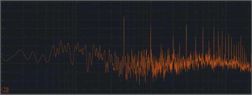

This image shows the waveform as recorded by Goldwave:
It obviously isn't square and a 100Hz signal has the same general shape although perhaps not quite as bad. It could also be the audio card in my PC but is this to be expected with low frequency waveforms?

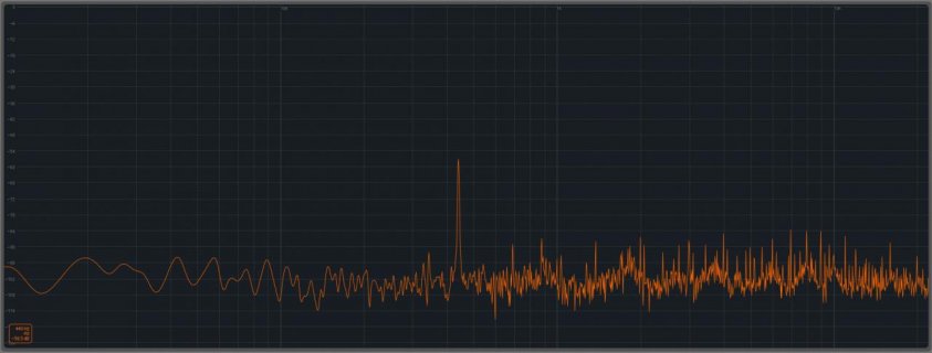

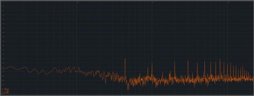

AudioSynthWaveform does not work very well at high frequencies.
This is the spectrum of a 5kHz signal from AudioSynthWaveform:
and this is the spectrum of a 5kHz signal from my code which uses the arm sine function.
The cubic interpolation used by the arm sine function will produce better results than linear interpolation but it takes a bit more cpu time. AudioSynthWaveform uses up to 2% whereas my arm sine version uses 6%.

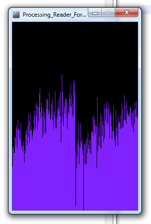

AudioInputAnalog (Built-in ADC) working with FFT
Looks like the "approx 5.38 Hz high pass filter" in AudioInputAnalog was the second issue. Just installed 1.18 and here is what is required to get a nice FFT working from AudioInputAnalog (built-in ADC).

The floating point FFT (f32) produces a much nicer output vs fixed point (q15). Didn't think it would be that much different given the input data is fixed point. Maybe something else is wrong I didn't catch when trying q15.

If I begin increasing the volume, the next step introduces quite a big jump in volume (>20dB). The led on the T3.1 flickers when going frpom 0->1. Is this normal, that with the volume set to 0 i still have the output of mysine?
Also, as you can see on the pictures, I experience a constant, high pitched background noise, I guess this has to do something with ground problems, or the power source(laptop usb output)? On pic 2, i added a sh*tload of gain to the signal with the volume turned all the way down. Here is an audio sample about this.
Any advices?
