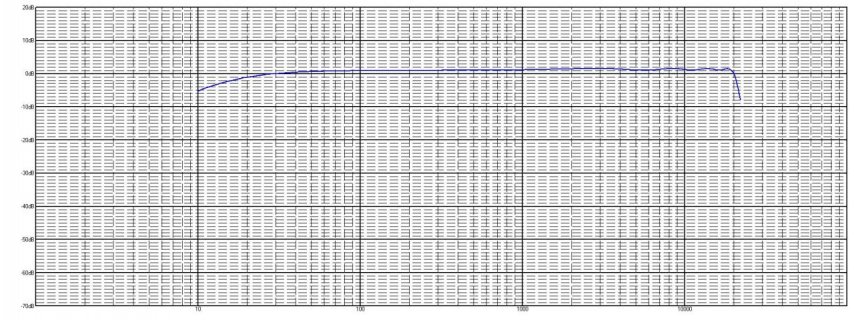

@JBeale
TL;DR look at the picture, and read last sentence below...
I am working up a Teensy 3.1/Audio Adapter based 'audio sweeper' for my employer so I needed to know that too. I've a sketch I'm working on which outputs a sine wave something not too far off 894mV PP on both lines out on Audio Adapter, and also on the DAC, and then it reads the SGTL5000 inputs (as lines in) into peak holding objects for an appropriate amount of time, sends results by Serial and changes the frequency to the next frequency in a table of frequencies adequate to cover 10Hz to 22050Hz in 276 steps without losing too much detail - current batch of code isn't tidiest and I intend some improvements to timing etc or I would just post it as it is right now; if nobody insists on seeing it sooner I will post it when I am really really proud of it ;)
Picture is Audio Adapter line out to Audio Adapter Line in measuring the peak result of sending a sine wave at a fixed amplitude across that frequency range; It is very very very similar per channel.
@robsoles Thank you very much for that graph, that's what I wanted to know! Looks like 10 Hz is roughly 6 dB down from the 1 kHz value, so there is still a fair amount of signal there. So you are doing a loopback measurement, does the signal plot use the SGTL5000 line out or the Teensy3.1 DAC? Or is the per-channel comment saying the two signal sources are nearly the same? I know the T3.1 DAC has ouput to DC, of course, in which case the low-frequency rolloff would be due just the input. Not sure if the audio adaptor output goes down to DC or not; they might have rolled it off to prevent some problems with DC going through headphones etc.
Note to Paul: I think it would be handy to see such a graph on the audio board product page :).

@JBeale: Very welcome. It is solely Audio Adapter outputs looped back to Audio Adapter inputs, my comment referring to left and right channels. I am yet to rate the DAC on Teensy beyond observing that it isn't too outrageously different (amplitude/Vpp) compared to Audio Adapter outputs when probed with an oscilloscope, not compared properly coz only probed one at a time on there and I haven't set up decoupling or buffering for it yet so I'll do that before rating it. If I read (and remember) all the appropriate parts of the SGTL5000 datasheet then the ADC has a high pass filter that we can bypass with the right access (I will submit an addition pull request soonish) and the only mention of a high pass filter in the DAC is related to DAP Bass enhance and, again, is optional.
Actually, reviewing my code I noticed that I put .dac_vol(97) in setup() because the difference between the output peak values and the input peak values was pretty big for my liking. I saved a new copy of it and modified it to use .dac_vol(100) and to sweep from 1Hz to 22049 - the PC based piece of software I am working on as the partner to this is what gave me the last graph and it is geared around the sweep starting at 10Hz so badly that I don't want to muck around making it plot this data starting from 1Hz, I am sure the majority of people who want to see it plotted will be able to plot it themselves but if anybody really insists I could get around to plotting it I guess.

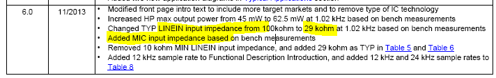

I suspect the SGTL5000 is DC-coupled internally and the high-pass comes from the external input and output capacitors.
The latest version of Freescale's data sheet (http://cache.freescale.com/files/analog/doc/data_sheet/SGTL5000.pdf?pspll=1) mentions that SGTL5000.PNG
the LINE in and MIC input impedance parameter values have been updated (29 kohm and 2.9 kohm). With the 1 uF LINE_IN coupling capacitors (0.1 uF on MIC) on the reference design, this would give a cutoff of 1/(6.28*29k*1u) = 5 Hz for LINE_IN (and 500 Hz for MIC).

@JBeale
@robsoles: thanks, great info. I plotted your data and it looks good from 2Hz up. The 1 Hz value looks like a glitch of some sort but I can ignore that.
