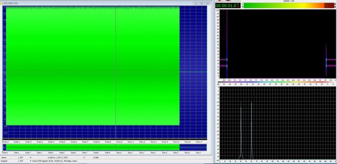

@Rich:
I think your scaling needs to shift down by 15. When you multiply two signed 16-bit numbers (i.e. 1.15 format) the result is a 2.30 number - i.e. the top two bits of the 32-bit number will be the same and will both be the sign bit. If you shift this down by only 13 bits, you haven't shifted either of the top two sign bits down to the sign bit in the lower 16-bits. At least, that's what I think happens. I will have to play with it sometime.
Pete
@Rich:
Pete
Yeah - so actually it should be >>14. I used a 13 bit shift to scale the output 2X and I didn't see any problems with it. It will clip if you multiply a square wave by a sine but sin**2 for example yields a fairly small output as does sin * audio which is what I'm doing. You can scale the inputs appropriately to avoid clipping or I suppose the output scale factor could be made settable.
What I have not investigated is clipping due to DC effects. e.g. as I recall sin**2 yields a doubled frequency plus an offset. Those crazy trig identities we had to memorize in school come up often in the RF world.
Rich
I think the problem with scaling is because there is a bug in my AudioSynthWaveform code when it produces sin waves. I have a pull request pending to fix that but it isn't in yet.
You can patch your local copy by editing libraries/Audiomaster/synth_waveform.cpp. At about line 96 there is a case statement for TONE_TYPE_SINE. Replace that entire case statement with this code:

I think you will then find that you should shift 15 places in your multiplier.
Pete
Pete
That definitely helped. When I scale using >> 15 output level is much better. If I multiply two sines I have to scale them to about 0.8 or the result clips which seems a bit odd. Above about 0.7 the sine output of AudioSynthWaveform clips regardless of the volume setting. I should be able to set the level of a sinewave to 1.0 without clipping - no ?
Rich
@Rich:
I (heavily) modified your sketch so that it produces the two sine waves, multiplies them and then outputs the resulting samples to a WAV file on the uSD card - I haven't yet released the code which records the audio to a WAV file.
The routing and tone generation look like this:
AudioConnection c3(toneHigh, 0, mult, 0);
AudioConnection c3a(toneLow, 0, mult, 1);
AudioConnection c13(mult, 0, recorder, 0);
  toneLow.begin(1.0,1000,TONE_TYPE_SINE);
  toneHigh.begin(0.99,vfo,TONE_TYPE_SINE);
where vfo = 5000;
I played the resulting file with GoldWave and the spectrum shows two spikes, one at 4kHz and one at 6kHz. I think that is the correct result of that multiplication, right? The oddity is that there is a DC offset that I can't explain. I've attached a screenshot of GoldWave playing that file. You can see that the audio does not clip.
This was with my fixed version of AudioSynthWaveform and I also changed your multiplier to scale down by 15.
How are you detecting clipping? I was testing my original changes to AudioSynthWaveform by playing the output into GoldWave on the PC and although I was sure the scaling after a multiplication should be 15, GoldWave showed massive clipping, so I shifted by 17 to stop the clipping. The problem, of course, is that the audio was being amplified before GoldWave saw it. That's why I wrote the code which records audio output to a uSD card. I could see for certain what the Audio library was producing.
Pete
Pete.
The spectrum is correct - double sideband suppressed carrier.
I saw clipping with my scope at the line out pins even with the volume set to 20. There are multiple places in the codec when clipping could occur tho so its probably due to some internal gain. Your test is right at the limit numerically so it wouldn't take much.
The DC offset is curious. Is it possible there is a bit of numerical bias in AudioSynthWaveform ?
A .wav recorder will be a nice addition!
Rich
I also recorded the two tones separately and they are both full scale waves so whatever is going on is after AudioSynthWaveform.

I think the DC offset has something to do with the relationship between the two frequencies, 1000 and 5000, and the sampling frequency of 44100.
I changed the code to use (arbitrarily chosen) 1367 and 5111 and output the result of multiplying them to the uSD. The result is a full-scale waveform.
Pete
