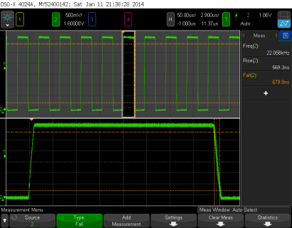

Today I've been working on supporting Teensy 3.1's built-in DAC in the audio library. I currently have it running with interrupts and I hope to convert to DMA soon.
I have a bit of excellent news to share. It turns out the DAC's bandwidth is much better than Freescale's datasheet specifies: 15 us typical, 30 us worst case.
But if you check out this scope capture, the rise time is approx 0.6 us. While this measurement isn't precise enough for checking settling to 0.8 mV, visually it looks like the waveform setting pretty well in about 1 to 2 us.
(click for larger)
As you can see, it's easily capable of creating a 22 kHz square wave. The 30 us worst case was a bit slow, but it turns out the hardware is at about 10X faster than the datasheet says, so full bandwidth audio won't be any problem at all.
