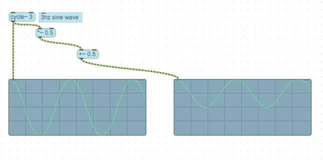

I'm not sure if there's another way of doing this but it could be nice to have a "Constant" object that would be a fixed value. This could be useful for objects like multiply if you want to multiply the signal by a constant value.
There's one thing I'm not sure is possible right now, is there a way to offset a signal in the positive range using the DC object ? (See image)
This seems like it would require an Add object.
Edit: ah the mixer would work for this. Sorry no more questions :)

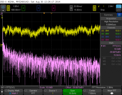

I've added a pink noise generator.
SPI flash support is on my list.....
Edit: here's a scope view of the pink noise.
Sadly, my scope doesn't have the ability to display the spectrum's horizontal axis on a log scale, where pink noise ought to have a perfectly straight diagonal line.
I did import reference data from Stefan Stenzel's reference code into audacity and it does look very good, and I compared the binary output from the first several blocks to the reference data.
