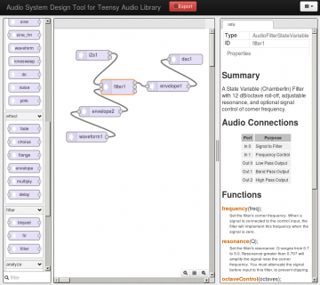

Finally, after 2 solid days of struggling with numerical approximations in fixed point math, I've finished the control signal input for the state variable filter.
The filter produces 3 outputs: low pass, band pass, and high pass. Previously it only took the signal in to filter. Now you can feed a control signal to modulate/sweep the filter's corner frequency.
The filter coefficient is recomputed on every audio sample, so at least in theory you can control the corner frequency with any audio signal. I had earlier considered recomputing the coefficient every 2 or 4 samples to conserve CPU time, but in the end I went with recomputing it at the full sample rate.
The GUI has been updated with documentation for this filter. Just connect any audio signal to the second input, and set the center frequency and number of octaves you want your control signal to modulate it, and you've got a "voltage controlled" filter!!
I've done a LOT of testing by checking numbers, and some testing with sine waves from my function generator, but so far no testing with actual audio. Please, if you're interested in the VCF, give it a try and let me know how it works for you?
Edit: Here's a screenshot in the GUI.
(click for full size)

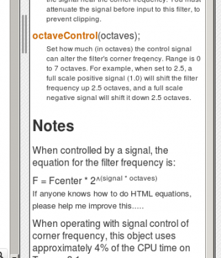

Also, if anyone knows how to do equations nicely in HTML markup... I could use a hand with this bit:
Your options are
- use <sup> and <sub> (easy, limited)
- put classes everywhere and set font size, relative positioning in CSS (morte complex, still not great)
- use MathML and then include a javascript library for all the lame browsers that don't support 9or removed support for) MathML (verbose, but adequate)
For MathML, MathJAX is recommended.
The simple power law equation you have looks fine to me as it is, by the way.
Regarding equation documentation, I was kinda hoping someone might actually *do* the conversion and post text that might be copied into the html. Sure, pointers to web technologies are great.... if only I had a lot more hours in every day!

I just setup server for work where they wanted this for mediawiki and I had the exact same problem in displaying formulas in a nice way. There is really no html or java script you can use that I know that will just work. You have to install some type of package for your webserver and setup the server to use it. I personally used Latex and I will say its probably not worth your time. That being said I found this website where it looks like you can type up your formula and embed it like so.
<a href="http://www.codecogs.com/eqnedit.php?latex=\fn_cm&space;\LARGE&space;F&space;=&space;Fcenter&space;*&space;2^{signal&space;*&space;octaves}" target="_blank"><img src="http://latex.codecogs.com/png.latex?\fn_cm&space;\LARGE&space;F&space;=&space;Fcenter&space;*&space;2^{signal&space;*&space;octaves}" title="\LARGE F = Fcenter * 2^{signal * octaves}" /></a>
I haven't tried this with our server though so I don't know if actually works.
